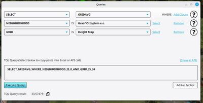

The Query Tool is a support tool in the Tygron Platform that aids the user by constructing data requests in the Tygron Query Language (TQL) and displaying the query output. By using this tool, the user can quickly verify if the data needed can be extracted from the project data with the available query elements. Also the tool allows for verification of the validity of the retrieved data. All this can be achieved without creating and uploading a dedicated Query Spread Sheet. See also: Excel (Indicator)

SELECT Result Parameter WHERE Clause AND Clause AND Clause AND... etc.
The Query Tool provides an interface in the Editor that allows for quick creation and verification of such TQL Queries.

  • The Query Tool can be used to verify if data is available for queries in the project area.
  • The tool can also be used to create queries, which can be copied and pasted in an Excel file to be uploaded as an Excel Indicator.
  • The reverse is also possible, recreating a query in the tool from an Excel Indicator file, to verify if the query actually grabs data from the project area.
