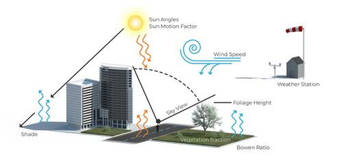

The DPRA Heat Module for the Heat Overlay can be used for heat stress calculations, based on geographical features and locale parameters. The final result is the physiological equivalent temperature, which is a measure of temperature which takes into account factors which can change the experience and effects of temperature.
The module performs these calculations in accordance with the DPRA Heat stress report.

The calculation of the Heat Stress Overlays takes into account:

The following factors influence the Physiological Equivalent Temperature for locations directly in the sun:

The following factors influence the Physiological Equivalent Temperature for locations directly in the shade or at night:
