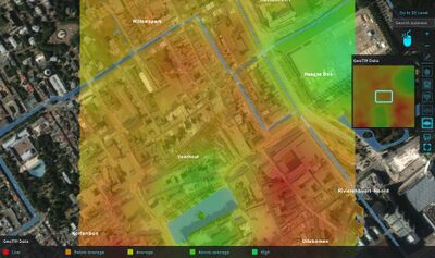

A GeoTIFF Overlay, where the data of a GeoTIFF is displayed.
The GeoTIFF Overlay is a Grid overlay which displays the values of a selected GeoTIFF in the project area. It is commonly used to display raster data imported into the Project from outside the Tygron Platform.
When clicking on a specific location in the map of the GeoTIFF Overlay, the hover panel gives additional information over the actual value in that specific grid cell. That value will be an interpolation, determined by the translation between the source file's resolution and the grid cell size.
