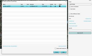

GeoTIFF Manager.
A GeoTIFF Overlay can be used to visualize the grid data of one or more GeoTIFFs.
Editor → Current Situation (Ribbon tab) → Overlays (Ribbon bar) → The GeoTiff Overlay (Left panel)
How to select one or more GeoTIFFs for a GeoTIFF Overlay:
  1. Select the GeoTIFF Overlay to configure.
  2. In the right panel, find the "GeoTIFF(s)" entry, and click on "configure". Alternatively, select the "TIFFs" tab.
  3. At the bottom of the right panel, select "Add". This will open the GeoTIFF Manager.
  4. If the desired GeoTIFF is not yet part of the Project's Assets, opt to add a new file at the bottom of the GeoTIFF Manager.
  5. When the desired GeoTIFF is listed, select it in the list of GeoTIFFs.
  6. If multiple GeoTIFFs are desired, select all desired GeoTIFFs.
  7. With the desired GeoTIFF(s) selected, click on "OK". This will close the GeoTIFF Manager.
  8. The GeoTIFF is now used as input for your GeoTIFF.
