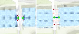

Weir width (Water Overlay)
This figure depicts the original way of implementing weirs (left), and the current way they are implemented in the Tygron Platform (right)
