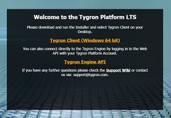

Download the Tygron Platform client application. It can be found here:
https://engine.tygron.com
The web page will prominently present a link to download the installer.

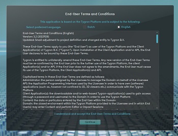

The end-user license agreement will be shown.

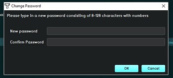

Click on "Change my password". A prompt will appear with which you can change your password to one you can remember.
Enter a new, personal password.

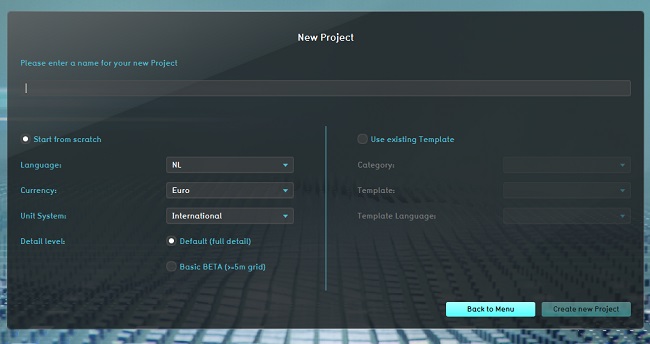

In the main menu, click on "Create new Project".
Use "New Project" to create a new Project.
This will start the New Project Wizard.
The "New Project Wizard" guides the process of creating a new Project.

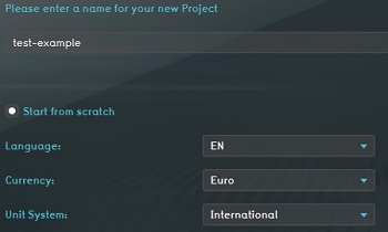

Enter a name for the new Project. A Project name should usually indicate the geographical setting where the Project is located. When creating a new Project for the purpose of experimentation, such as a tutorial, it is generally convention to have the project name indicate the person the Project belongs to, e.g. test-yourname.
The name must be between 3 and 20 characters, and may consist of alphanumeric characters, spaces, and dashes.
Enter a project name.
When creating a new Project, it is possible to either create a new Project from scratch, or to base the new Project on a pre-existing Project. Ensure the option for creating a new project is selected.
Set the Projects language to the desired language, the currency to the desired currency, and the measurement system to "international".
Settings for a new Project.

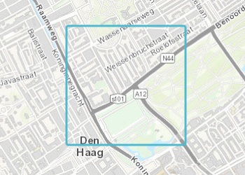

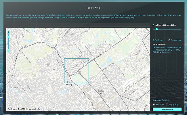

This screen allows the selection of the geographical location and size of the new Project.
The location selection screen.
Use the search bar to locate the general area where the Project is to be located.
Move the map using the right-mouse button.
Use the left mouse button to place the blue selection zone in the appropriate location. Everything within the blue extent will be part of the Project and the 3D visualization. Anything outside the blue extent will not be part of the Project and the 3D visualization.
The blue selection field indicates the extent of the Project. Align it to oncompass your area of interest.

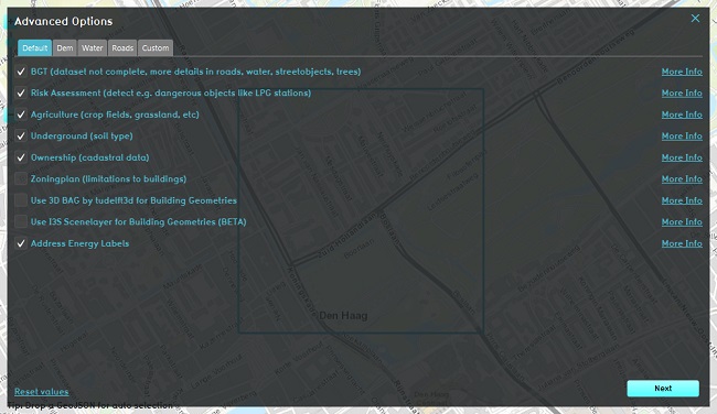

Click on "Advanced Options". This opens an additional panel in which some specific datasources can be toggled or configured. Some datasources can be explicitly includes or excluded from the process of generating the Project.
The advanced options allow for further configuration of what data is loaded in for the new project.
Disable the "Ownership" options. This will disable the Tygron Platform from generating a complex ownership situation, which might inhibit the free application of tools for sketching a future situation using Actions. Disabling the import of ownership data is a best-practice.
Turning the ownership data off is not required, but helpful for most use-cases.
Click on "Generate". This will start the data import process on the Tygron Platform server.

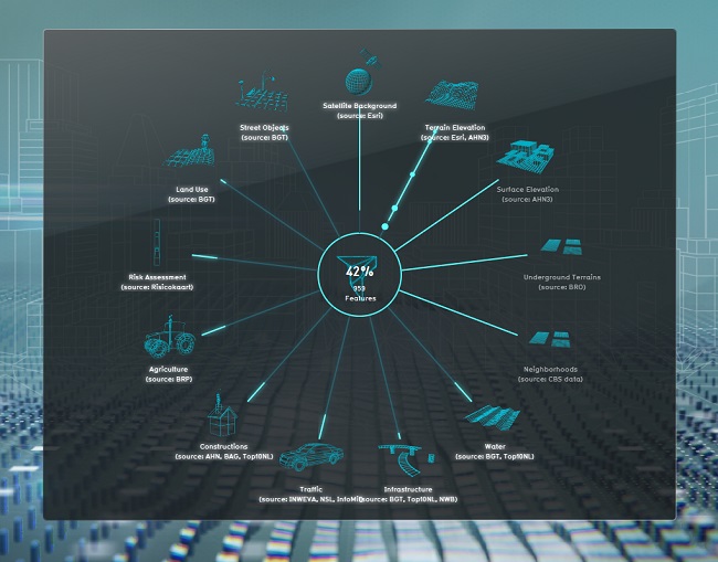

The Tygron Platform is retrieving all the neccesary data. You can see the progress locally.

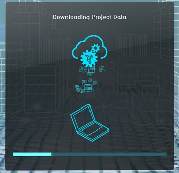

After the generation process completes, the editor environment and 3D Visualization will load.
The data of the Project is being downloaded to your client application, so that the 3D world can be shown.

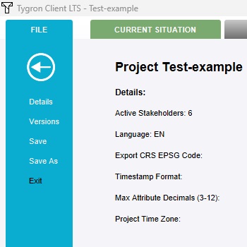

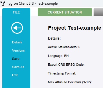

Before exploring the editor, click on "File" in the top-left corner of the screen. This will open the File menu for the Project.
The file menu button in the top left of the interface.

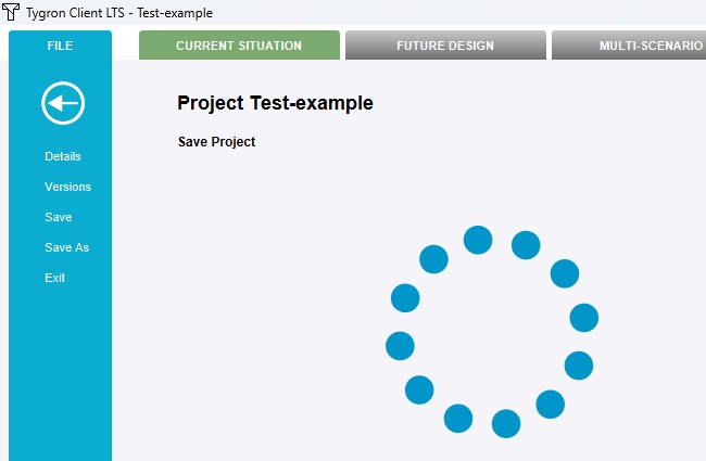

Click on "Save" to save the Project.
Click on "Save".
The current state of the Project will now be saved.
Depending on the complexity of the Project, the time it takes to save may vary.

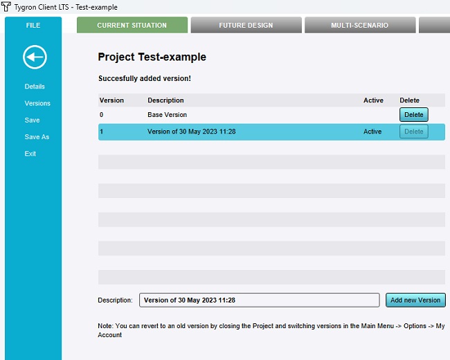

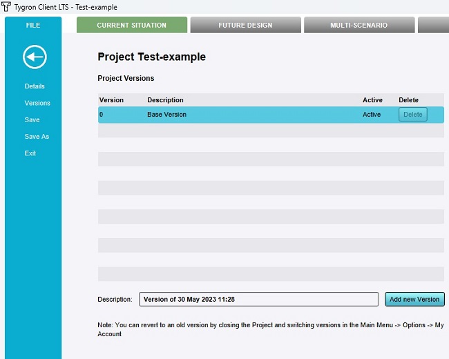

After the Project has saved, click on versions.
The list of versions of a particular Project.
Each Project can have a maximum of 10 versions within it. Versions are used to create known states of a Project, to which it is possible to revert if so desired.
Click on "Add new version". This will save the current state of the Session in a second version. The second version will now be listed, and this new version will also be marked as active.
A new version is now added to the list of versions for this Project.
If changes are now made to the Project and the Project is saved, those changed will be stored in the new version. At any point in the future, it will be possible to revert the Project back to the initial "Base Version", which will not include those changes made in the second version.
It is important to note that the Tygron Platform does not have an "undo" button. To revert (complex) changes, the appropriate approach is to save periodically when the state of the Session is correct, using versions to maintain those states, and either closing without saving or switching to earlier versions to remove or revert the changes.

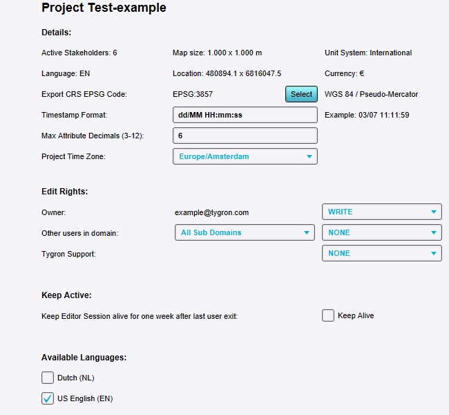

Click on "details". This will open the overview of general meta-data of the Project.
Details and meta-data of the Project.
The meta data of a Project includes an overview of the permission which dictate who can access this Project and Session.
Permissions can be set for:
  • Owner, which is generally the User whom created the Project
  • Other users in Domain, which are all the Users in the same Domain
  • Tygron Support, which is any Tygron employees
The rights for any of these can be set to any of the following levels:
  • NONE, which means the Project cannot be accessed.
  • READ, which means the Project can be opened as a Session. Data can be inspected and modified, but not saved. Saving a copy to create a new Project is allowed.
  • WRITE, which means the Project can be saved as well, allowed its data to be permanently changed.
The permissions of the Project.
Note that any newly created Project (including one resulting from copying an existing Project), will have all rights except of that of the owner set to NONE. This is in line with Tygron's privacy-by-default policy, requiring explicit granting of access to others.
Also note that because the permissions for Tygron Support are set to NONE by default, Tygron employees cannot access a Project's data without explicit approval.

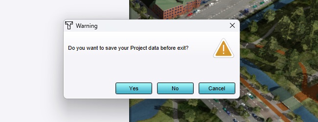

A prompt will appear to ensure you wish to exit, and whether the Project should be saved before closing. Opt to close the Session, either with or without saving.
Before closing the application, confirm closing the application is intentional by indicating whether to save the Project or not.
The application will now close. The client application always closes fully when exiting a Session. Additionally, because there are no more Users active in the Session, the Session itself is also ended on the server. Because the Project has been saved manually before closing it, the Project data will continue to exist on the server even after the Session has closed.

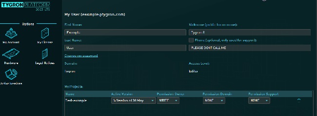

In the main menu, click on "options", and then "my account". Notice that now a Project is listed, specifically the Project created previously.
The "My account" overview now displays a list of Projects.
The permission settings, which could be edited from the Editor, can also be set from this overview.
Permissions for the Project listed, without opening the editor.

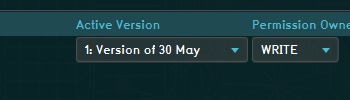

Additionally, if at any point a Project should be reverted to a previous version, that can be done from this overview as well. Note that no Session of the Project may be running while changing the Project's version.
The active version of the Project can be set here.

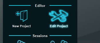

Go back to the main menu, and click on "Edit Project".
Editing a Project allows for opening a Project which already exists.
The list of Projects includes:
Select the Project created as part of this tutorial.
Click on the Project to select it.

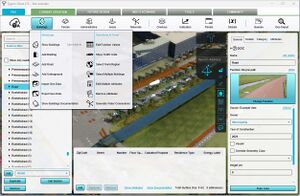

The editor can be considered to consist of 2 levels of interface:
  • The 3D visualization and related User Interface in the center of the screen, with mostly dark-colored interface elements.
  • The surrounding/overlaid editing interface, with mostly bright-colored interface elements.

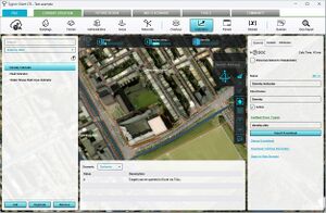

The editor, with the bright editing interface elements at the top, and the darker User Interface over the 3D Visualization.

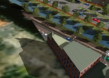

Exploring the 3D visualization
The 3D visualization is a visualization of the data in the Session, as a unified 3D world. All elements which can be seen in the 3D environment are based on data present in the Session.
Camera
The 3D visualization is facilitated through a camera, which has a position (the point at which the camera is located, and looking "from"), and a focal point (the point at which the camera is directed, and looking towards).
Click in the 3D world, and move the camera. Try the following motions:
  • Hold down the left mouse button, and drag the 3D world, to move the camera along the horizontal plane.
  • Hold down the right mouse button, and drag the 3D world, to rotate the camera around the point the camera is pointed at.
  • Scroll the scroll wheel up and down to zoom in and out.
There are multiple camera modes available, which can be switched between. Find the camera icon at the top right side of the User Interface.
The camera icon allows switching between camera modes.
Change the camera mode by clicking on the icon, and again try to move, rotate, and zoom the camera.
Move the focal point of the camera as far to the side as possible. Notice that when the edge of the Project area is reached, it is not possible to move any further. The camera is always directed at a location inside the Project area.
The camera cannot move beyond the Project Areas edge.

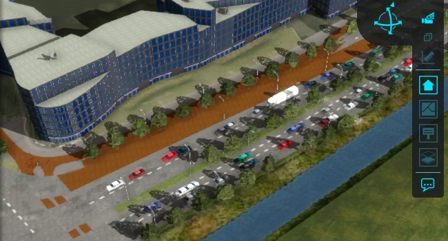

On the right side of the screen, a list of icons is displayed. These icons represent Overlays, which are map layers which can be switched between. By default, the following Overlays are available:
Icon Overlay Description
Base Shows the 3D world as-is, without additional information.
Neighborhood The Neighborhoods the world is divided up into.
Ownership Shows what areas and what Buildings are owned by which Stakeholders.
The list of Overlays allow switching between different available Overlays.

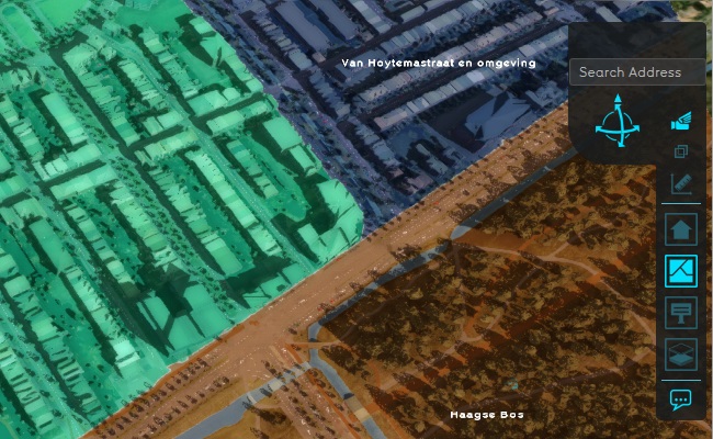

Click on the icons to switch between the Overlays. You will see the 3D Visualization now includes an additional overlaid image displaying specific information.
Neighborhoods visualized by viewing the Neighborhoods Overlay.
A legend panel is also displayed at the bottom of the user interface, clarifying the meaning of the colors of the Overlay.
The legend panel of an Overlay clarifies the visualized colors.
Note that, because the "Ownership" option was turned off while creating this Project, there is no detailed ownership data available. The Ownership Overlay will still display the state of ownership of the data in the Project, but all land and Buildings are owned by the default Stakeholder, which is the municipality.

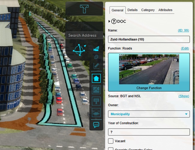

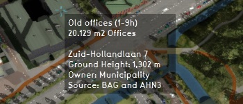

Select the base Overlay again, and click in any location in the 3D visualization. A hover panel will appear, giving more information about that location.
The hover panel will show more information about any selected point.
Switch to a different Overlay, and click in any location in the 3D visualization again. The hover panel will again appear. The hover panel and the active Overlay are always related, so the information displayed will always relate to the Overlay displayed.
The hover panel will display information relevant to the used overlay.

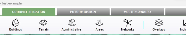

Ribbon tabs
All options in the editor are divided into groups of data and tools. The groups can be switched between using the tabs at the top of the ribbon. The tabs are:
  • Current Situation, which defines all the base data of the Project, and the calculation models with which to analyse them.
  • Future Design, which defines the tools which can be made available to explore potential future scenarios.
  • Multi Scenario, which defines tools to set up and compare multiple future scenarios.
  • Tools, miscellaneous tools, including recording tools, access to the API and web interface, and tools for Project templating.

Ensure the "Current Situation" tab is selected.
A colored "Current Situation" tab means it is selected.

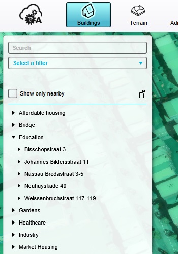

Click on "Buildings" (ignore the dropdown which appears). A left panel will appear in the editor, which provides an overview of all Buildings. The buildings are subdivided into categories (and Neighborhoods if there the amount of Buildings warrants it).
The Buildings option selected, lists the Buildings in the left panel.

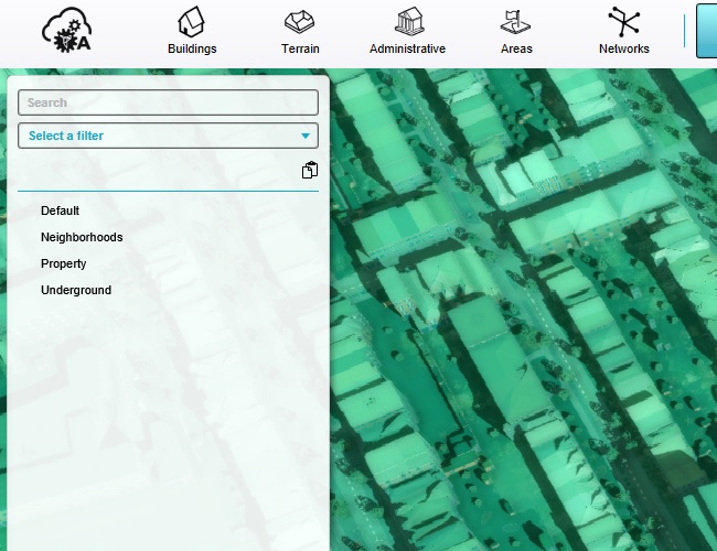

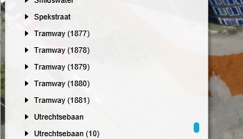

Click on "Overlays" (ignore the dropdown which appears). The left panel now lists all Overlays currently part of the Session. Notice that the Overlays listed in the left panel of the editing interface are the same as the Overlays listed on the right-hand side of the user interface.
The Overlays option selected, lists the Overlays in the left panel.

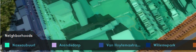

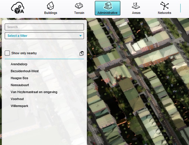

Click on "Administrative" (ignore the dropdown which appears). The left panel now lists all Neighborhoods, which are the primary administrative subdivision of most Projects.
The Neighborhoods option selected, lists the Neighborhoods in the left panel.

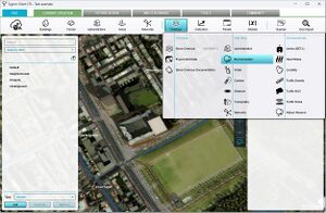

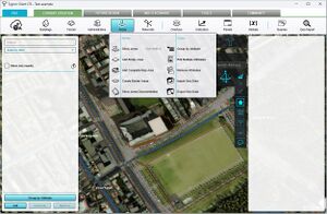

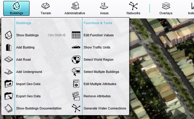

Hover over the "Buildings" button, and a dropdown will appear with further options.
Hovering over one of the options in the ribbon shows a dropdown.
In general, dropdowns provide access to quick options for adding extra data of the specified type, options for data import- and export, access to related data such as typology, and access to documentation about that particular kind of data or feature. The exact contents are always dependent on the data or feature.

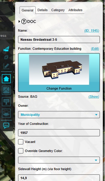

Open the list of Buildings again. Select any Building in the list of Buildings. The right panel will display information about the specific Building selected.
Details of a specific building selected in the left panel, displayed in the right panel.

For geographic types of data, it is also possible to click on the element in the 3D Visualization. Click on a road where cars are visualized, so that it is highlighted in the 3D Visualization and the right panel shows information about it.
This also works for roads (or other buildings) where no cars are shown, but for a later step it is most interesting to have a road with cars.

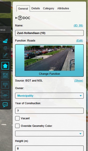

A road selected. It is highlighted in the 3D Visualization and its details are displayed in the right panel.
In the right panel, the individual properties of the road building can be viewed. Depending on the type of data, the exact layout of the right panel of the panel will vary. For Buildings, the right panel is divided into a number of tabs, with the General tab displaying some overall properties such as the name, the building type, and the owner.
The General tab also displays the source for the data. If the data was created during project generation, one or more sources will be listed from which the Tygron Platform has derived it.
The General tab of the right panel usually shows all common and/or basic properties of any kind of data.
Buildings also have properties divided into a Details tab and a Category tab. These tabs display a range of additional values for this Building, which in the case of Buildings are derived from their building type (In the Tygron Platform known as a Function).
The Details tab shows inherent Building (or Building-type) properties, and the values for this particular Building.

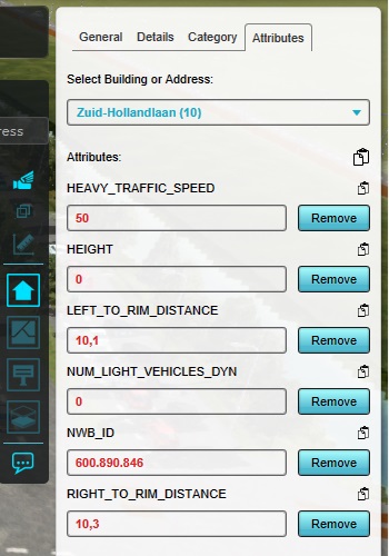

Lastly, there is the Attributes tab. This tab displays Attributes, which are effectively miscellaneous properties the data has. In the case of a roads Building in a Project in the Netherlands, for example, an NWB_ID Attribute may be added to the Building, which is a national standard identification for roads allowing them to be easily related back to external datasources.
The Attributes tab shows Attributes, which can be any additionally assigned property.
Attributes are a form of property related to many kinds of data, and can generally be used to hold any form of (custom) numeric value. working with Attributes is outside of the scope of this tutorial.

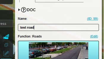

Data in the right panel can also be easily changed. Switch to the General tab, and change the name of the road to "test road".
The name of the road has been changed to "test road".
In the 3D Visualization, click on the road again so the hover panel appears. Notice the hover panel now displays the name "test road".
"The hover panel now displays the "test road" name.

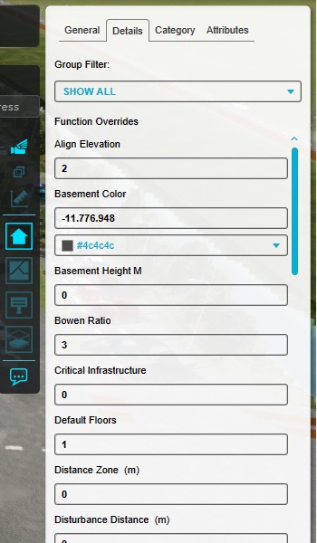

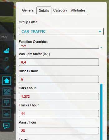

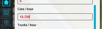

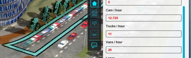

Switch to the Details tab, and find the "Cars / hour" value.
Note that it is easier to browse this particular overview by using the "Group Filter" option at the top to filter for only TRAFFIC-related values.
Traffic-related values for this Building.
Some (or all) of the values are shown in black, and some values may be shown in red. Because the Building is of a certain Function (which is effectively a building type), values are derived from that function. However, some values may be known for this Building in particular. These are the values that are shown in red, which are values which are related to the actual Building itself, rather than being inherited from the type of building it is.
Change the "Cars / hour" value to a value 10 times as much.
The amount of cars for the road has been increased ten-fold.
Notice the 3D Visualization now updates, and the amount of cars visualized on the road has increased significantly.
The road is now entirely full of cars, but only on the modified road.

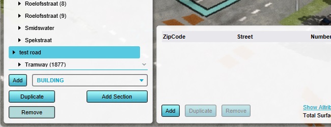

Data can also be added and removed entirely. In the left panel, ensure the "test road" building is selected. At the bottom of the left panel, click on "Remove".
The "Remove" button can be found in the bottom-left of the left panel.
A prompt will appear to verify the building should be removed, and that the action cannot be undone. Confirm the action, and the Building will disappear from the 3D Visualization. The road is now removed from the Session.
The road "test road" is no longer listed.

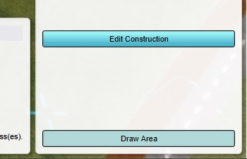

At the bottom of the right panel, click on "Draw Area".
The "Draw area" option. For (almost) all drawable data a similar option exists in the same location.

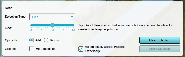

The bottom panel will now present a number of selection drawing tools, and is known as the brush panel.
The brush panel offers options to draw a selection in the 3D Visualization.

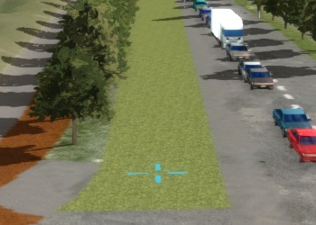

The 3D Visualization will also change, to show show where a selection can or cannot be drawn. Any place where the usual visualization can be seen is a valid location for a selection. Any place where a gray layer fades out the usual visualization is an invalid location for a selection.
For Buildings, the most common reason for locations being invalid to draw is because there is already a Building in that location. However, because a road was removed previously, a free location exists where the new Building can be drawn.
The visualization of where a selection can be validly drawn.

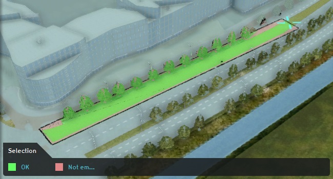

Left-click on one end of the free location where the new Building can be drawn. Then move the mouse so that a selection appears and extends across the intended location. When the selection is oriented appropriately, left-click again to place it.
Parts of the drawn selection may be green, and parts of the selection may be red. Do not worry about the red parts, they will be automatically ignored. Only the green parts of the drawn selection will actually be used.
A drawn selection, with green valid parts and red invalid parts. Only the green parts are used when the selection is confirmed.
A selection is now drawn in the 3D Visualization. In the bottom panel, click on "Apply selection". This will confirm that the selection which was drawn should be added to the polygons which compose the Building. This change to the Building also triggers an update of the 3D Visualization again, and the new road will appear.
A new road has been placed in the location where the (valid part of) the selection was drawn.
Because the Building which was drawn is a road, the "selection type" in the brush panel was automatically configured as a line. Although a broader explanation about using all the option in the brush panel is not part of this tutorial, it is worth noting that the precise default selection type may differ for different types of data, but that it is almost always possible to switch between selecton types.

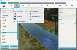

Terrains
Terrains are present in all Projects. Especially water is relevant.
Main article: Terrain Type
Terrain is the definition of the surface and subsoil. Each location has both exactly one surface Terrain Type, and exactly one underground Terrain Type.
Terrain Types may inherit from other Terrain Types. Similar to Buildings, their properties are derived from the Terrain Types they inherit from, but can also have their own values set.
There is, effectively, no such thing as a Terrain to edit separately from a Terrain Type. Instead, Terrain Types are drawn directly into the Project Area.
Surface Terrain can be seen in the 3D Visualization, with a height defined by the elevation model, and a texture defined by the Terrain Type.
Underground Terrain can be visualized using an Underground Overlay.

Neighborhoods can be visualized using a Neighborhoods Overlay.
