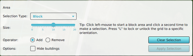

Brush Panel
The brush panel is not directly visible in the editor. Instead, it appears when it is required while using the editor, for example when clicking on the "Draw Area" button in the editor detail panel of a Building. The brush options that are available for configuration depend on the type of Item, or component of an Item, you are using the brush for.
Brush options
The brush panel offers a number of options, which will allow you to accurately draw a selection in the 3D visualization.
Selection Type
- The type of selection you wish to make. This influences the shapes you draw in the 3D visualization. By using the right selection type, it is possible to make intricate selections, exactly reflecting your intentions.
Size
- The size of the selection you are drawing. Depending the current selection type, the size will influence how large your selection will be. A higher size allows you to draw greater selections more quickly, while a smaller size allows you to make your selection more detailed. For some selection types, such as Ellipse and Poly, the size is used for removing previous selected points.
Operator
- The operation you wish to perform with your selection. Depending on what you are currently drawing a selection for, you may have the option to append to the existing spatial element, or to remove from it. For example, you can add to or remove from a building, but you cannot remove ownership, only overwrite it. By setting the operator to "Add", the selection (when applied) will be added to the spatial element. By setting it to "Remove", the selection (when applied) will be subtracted from the spatial element.
Options
- The options offer ways to make drawing easier. The currently available option is "Hide buildings", which will remove building from view. This allows you to draw your selection on the 3D visualization without obstructions.

Block
- Use this mode to draw rectangular areas consisting of square blocks. When moving the cursor in the 3D visualization, a grid will become visible. This grid will align with nearby spatial elements, such as roads, allowing the user to draw a selection parallel or perpendicular to things already present in the project. Click a first time with the left mouse button to start the selection of a rectangle. Move the mouse to expand the rectangle in the desired direction. Click a second time to add the created rectangle to the current selection. Adjusting the size in the brush panel will make the grid larger or smaller.
