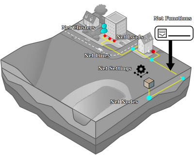

Net Lines in relation to Net Nodes and Net Functions.
In the Tygron Platform, net lines and net nodes, along with Net Loads, form distribution networks. They are defined by 2 Net Nodes, a starting node and an end node, and a Net Function. The collection of net lines and net nodes between two arbitrary net nodes is called a path.
