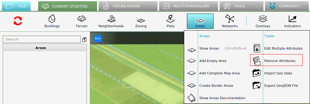

How to open the panel
Open the remove attributes panel by going to editor top bar. Next, hover a component that has attributes such as Areas.

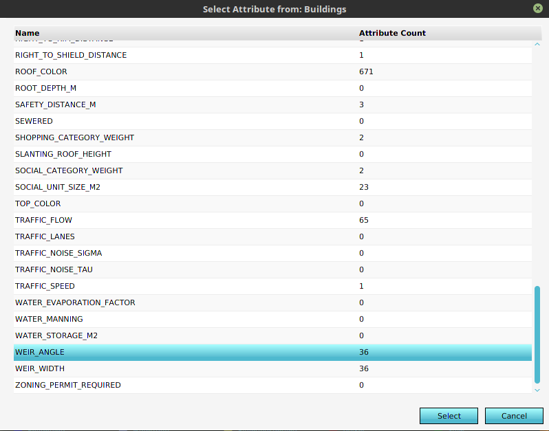

Select an attribute
Select an attribute from the list and click on the select button. Alternatively double click on the attribute.

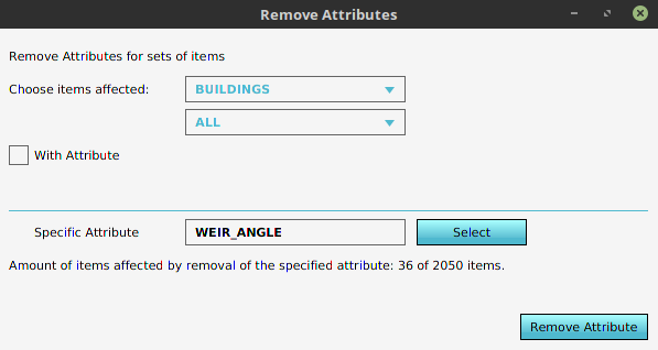

Option 1: No filter
Option 1: No filter, so all components of this type considered.

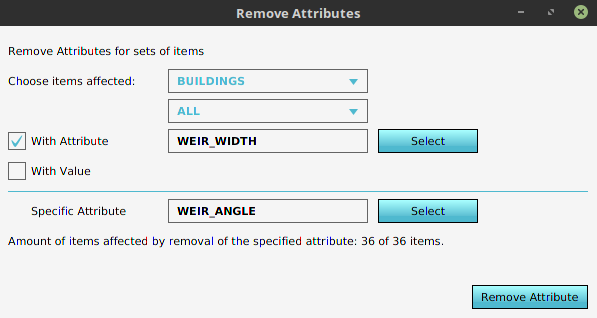

Option 2: Filter on attribute
Option 2: A filter requiring the component to have the specified attribute.

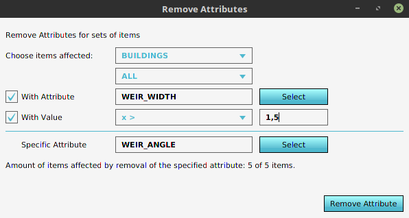

Option 3: Filter on attribute and value
Option 3: A filter requiring the component to have the specified attribute and its value to be in the specified range.
