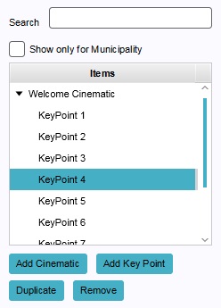

The left panel also allows you to select keypoints of cinematics.
How to add a new keypoint:
  1. Select "Visuals" in the ribbon header.
  2. Select "Cinematics" in the ribbon bar.
  3. Select the cinematic you want to add the keypoint to in the left panel.
  4. If there is already at least one keypoint present, select the keypoint you want the new keypoint to be added after.
  5. Select "Add Key Point".

  3. Select the cinematic from which you wish to remove a keypoint.
  4. Select the keypoint you wish to remove.
  5. Select "Remove".
