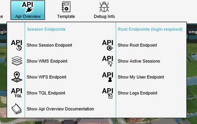

This page shows the overview of API options usable in the Tygron Platform, the API Overview can be found in the header of the Tools ribbon. More extensive documentation and information about the use of APIs in the Tygron Platform can be found on the REST API page.
