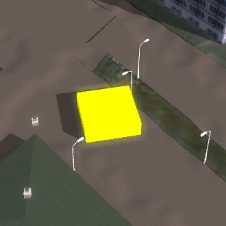

When the "Edit Camera Position" button is selected, you enter camera editing mode. This mode allows you to edit the camera location and orientation for the selected keypoint. In place of the "Edit Camera Position" button, new buttons will have appeared in the right panel to store the current camera position. In the 3D Visualization, an object will be visible to help orient the camera.
Moving the Camera
This object indicates where the camera is currently aimed at.
