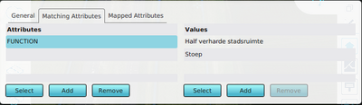

Matching Attributes
A list of Attributes which a feature should have in order to be imported. Each attribute can be configured to merely be present, or to need to match one of a list of values. This allows for filtering on a specific group of features only.
Example of a Geo Link that matches to a specific feature when it has this attribute and one of the two specified values.

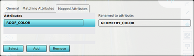

Mapped Attributes
A list of Attributes which are renamed on import. If the specified Attribute is present in a feature in the data, the resulting Item will have an Attribute with the specified mapped name with the same value.
Example of a Geo Link that maps a roof color to a geometry color.

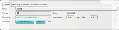

Geometry mode
Optionally a feature's geometry can be altered using the Geometry Mode and the line and point buffer values. This can be useful when the data consist of points or lines and have to be converted to a multi-polygon.
Example of a Geo Link for a type of tree where the geometry is always converted to the tree's trunk by taking the geometry's center point and buffering it with 0.5 meters.
