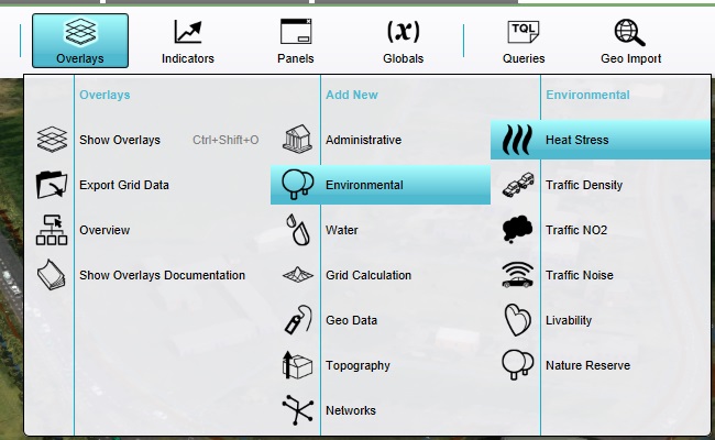

Editor → Current Situation (Ribbon tab) → Overlays (Ribbon bar) → Environmental (Dropdown) → Heat Stress
Add a Heat Overlay.
The Heat Overlay is easily added via the Overlays dropdown.

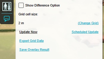

If the Heat Overlay does not immediately show results, click on "update now" in the right panel.
"Update now" will recalculate the entire Project.

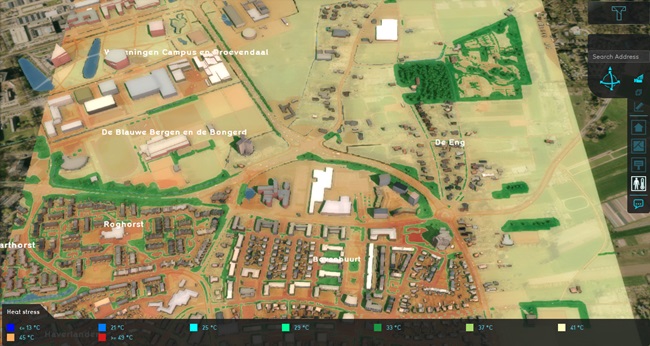

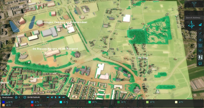

The Heat Overlay will show results, based on a default date and time, and its weather measurements. These defaults are based on the benchmark the RIVM has run, i.e. august 2nd, 2013, with weather station measurements from the Wageningen environment.
The results of a heat calculation.
The default result of the Heat Overlay will be the PET, or Physiological Equivalent Temperature. This is how a given situation of temperature is experienced by an average adult human.

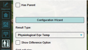

With the Heat Overlay selected in the editor, click on "Configuration Wizard" in the right panel.
The configuration wizard can be opened from the right panel.

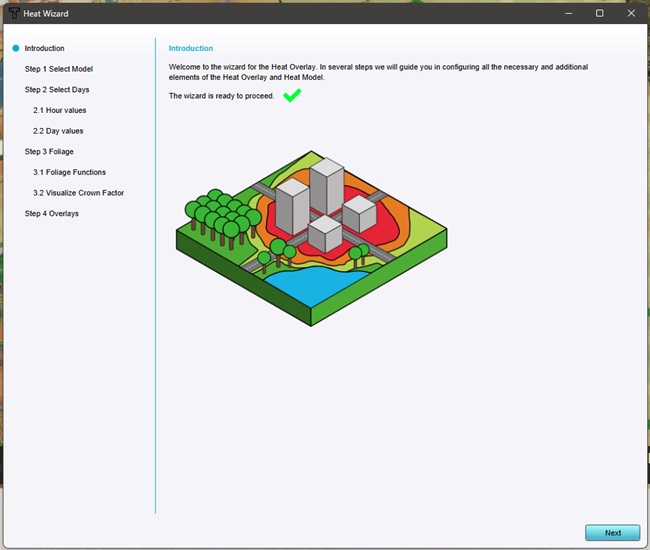

This will open the configuration wizard.
The configuration wizard.
Click on "Next" to continue to the first step of the configuration wizard.

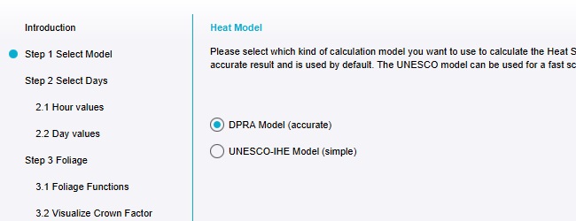

In the first step of the wizard, the applicable heat calculation model can be selected.
The Heat model selecton.
The DPRA model is the current and more accurate model. The UNESCO model is included for backwards compatibility reasions, but is no longer current or recommended for use.
Note that this tutorial is specifically for the DPRA model, disregarding the UNESCO model.
Ensure the DPRA model is selected.
Continue to the next step.

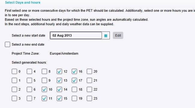

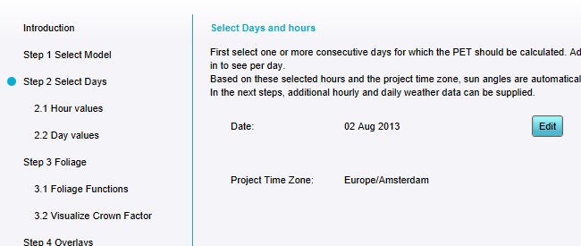

Next, the day and time for the calculation can be configured.
The selection of day and time.

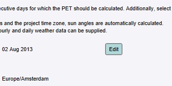

Based on the day, time, and the geographical location of the Project, the orientation and movement of the sun is automatically calculated.
In addition, multiple times on a single day, and even multiple days, can be configured. When more than one moment in time is configured, the Heat Overlay will automatically calculate multiple timeframes, each timeframe representing one discrete moment in time.
Click on "Edit" to change the configured date/time.
Click on "edit" to change the date and time(s).
The displayed hours are for the local timezone.
Ensure the following hours are selected:

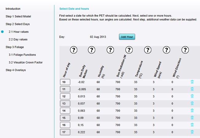

For every hour, specific weather measurement data can be configured to represent the changing weather conditions over the day.
The overview of weather values per hour.
For now, only take note of the kinds of data which can be configured in this step.

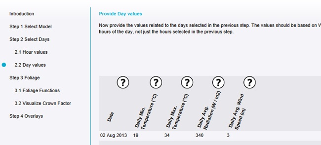

Besides a configuration per hour, averaged information for each given day is also required.
The overview of weather values per day.
As with the hour information, for now only take note of the kinds of data which can be configured in this step.

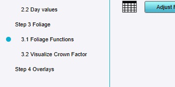

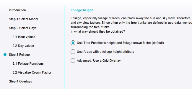

Foliage
One of the most impactful ways heat stress can be affected is through the use of foliage to create shade in an urban environment.
The options for foliage determination.
The Heat Overlay specifically requires foliage information to properly compute the height and location of shade. If no data specifically related to foliage is available in the Project, foliage data can be derived from Buildings such as trees.
Functions
When deriving foliage from tree Functions, foliage is determined based on the tree's height, and a foliage crown factor, which is the ratio between the tree's height and the width of the crown. The height of the foliage near the centre of the tree will be higher than the height of the foliage near the edges of the crown. This is the default mode.

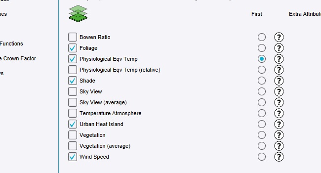

The last step for the proper configuration of the Heat Overlay is selecting the desired outputs.
The options for outputs from the heat calculation.
The calculation of the Heat Overlay takes place over multiple steps, parsing and combining different elements of geographical and non-geographical data to compute inputs for the next steps. For example, the Urban Heat Island is calculated based on features in the built environment, which in turn affects the heat retention and radiation.
The final result of the calculation is the Physiological Equivalent Temperature. The other options are intermediate results which may provide insight into the major component effects for the calculated heat stress, or be relevant in and of themselves such as the result of shade.
Ensure the following outputs are selected:
The end result of the heat stress calculation. This is how a given situation of temperature is experienced by an average adult human.
Foliage
The presence of foliage in the project area, as interpreted by the Heat Overlay, expressed as height of the foliage above the surface of the terrain.
Shade
The presence of shade in the project area, calculated based on the orientation of the sun and the Digital surface model.
Urban Heat Island
The calculated urban heat island, which represents the capacity for heat retention of the built environment.
Wind Speed
The calculated wind speeds, based on the wind speed provided as part of the weather data, and the presence of Buildings which can limit the free flow of air.

With the Heat Overlay selected in the editor, click on "update now" in the right panel to recalculate the results. This will include both the end result of Physiological Equivalent Temperature, and the child Overlays with intermediate results previously selected.
Recalculate the Overlay.

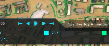

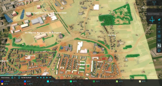

When the calculation has completed, in the Viewer interface, click on the "play" button in the legend of the Heat Overlay.
The play button in the legend of the Overlay.
This will show a progression of results, one snapshot for each moment in time as selected in the configuration wizard.
Heat results in the 3D environment.

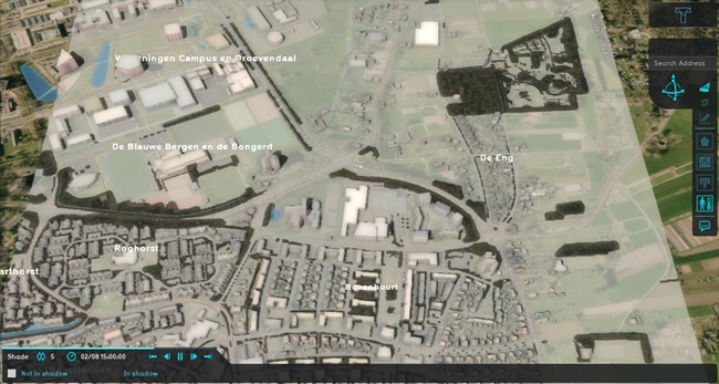

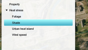

In the left panel, open the list of child Overlays of the Heat Overlay.
Select the Shade result.
Again, click on the "play button".
Notice how the calculated shades move across the built environment.
Shade results in the 3D environment.

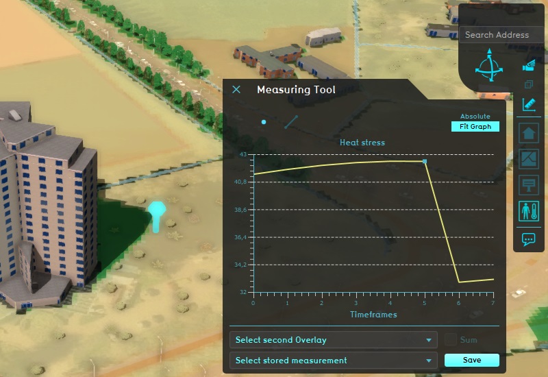

Switch back to the main Heat Overlay. Then, on the right-hand side of the Viewer interface, click on the "Measurement tool" icon.
The icon to open the measuring tool.
Click in any location in the 3D world to see how the temperature in that location progresses over time. Click on "Fit Graph" to scale the results for improved legibility.
The progression of temperature at the indicated point.

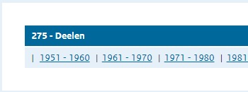

Next, select the desired decade. For example, the climate data for the 2nd of august 2013 can be found in the 2011-2020 decade.
The listed decades of data available.

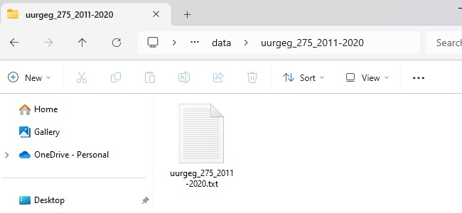

This will start the download of a zip file.
Once the download has completed, unpack the zipfile. This will allow access to a single txt file, which contains data structured as comma-separated values.

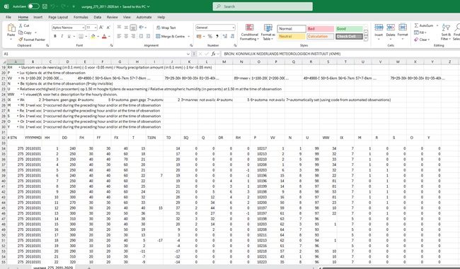

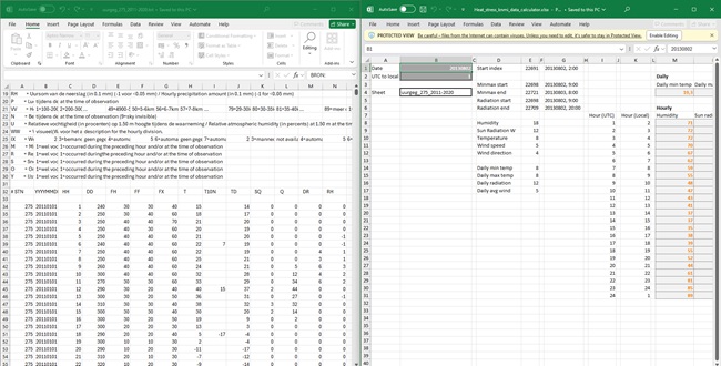

This csv file can be opened in Microsoft Excel.

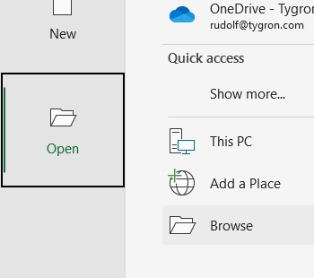

Start Microsoft Excel.
In the Welcome screen, opt to open a file, and select "browse". This will open the file selection screen.
The more detailed file accessing option.

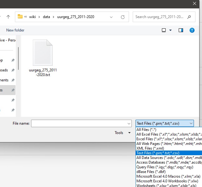

At the bottom-right of the file selection screen, set the file type to "text files", which include ".csv" files.
The file types allow for opening more varied datasets.

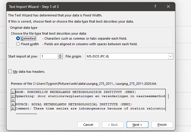

Select the .txt file downloaded, and opt to open it. This will open the "text import wizard".

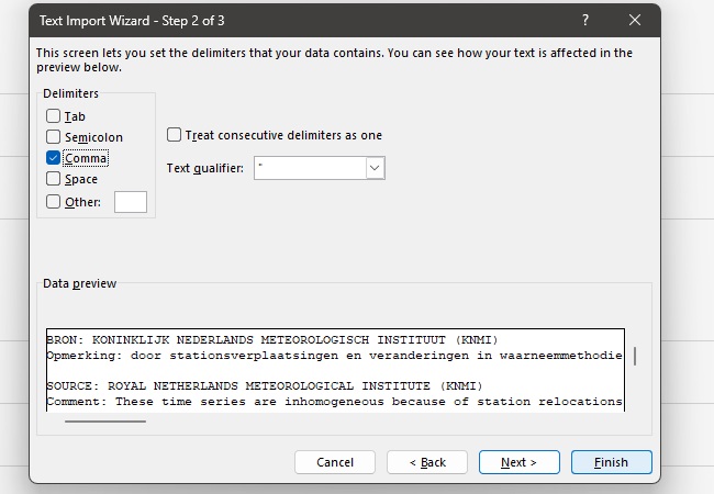

For the file type, select "Delimited", and click on next.
The selection of "separator" interpretation.
For the separator, select "Comma", and click on "Complete" to finish the wizard.
The separator should be a comma.
The KNMI weather data is now opened as a functional Excel workbook.
The data is now imported and accessible.
Note that the following step of parsing exact data from the workbook is described in reliance of an additional Excel file as assistive tool. Parsing the data can also be done manually, but this is a more involved process.
Download and open the Heat Stress KNMI data calculator Excel File.
https://support.tygron.com/wiki/File:Heat_stress_knmi_data_calculator.xlsx
You should now have one Excel instance open with the downloaded data, and a second Excel instance with the calculator tool.
Ensure editing is activated for both files.
Enable editing.

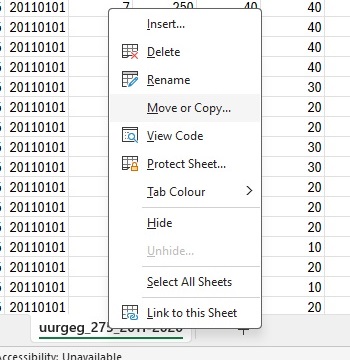

In the Excel instance with the downloaded data, right-click on the data's workbook tab, and select "Move or copy..."
Edit the tab.

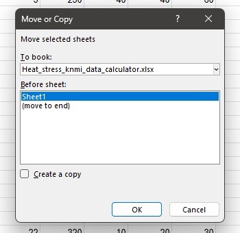

Opt to move or copy the data to the other Excel instance, with the calculator tool.
Moving the tab to the calculator.
When the operation has completed, in the Excel instance with the calculator tool, switch to the "Calculator" tab.
The calculator tab.

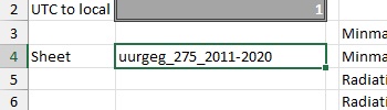

In cell B4 (preceded by "Sheet"), change the name of the target sheet to the dataset now added. This will direct the calculator to consult the data you downloaded and added.
The entered sheet name.

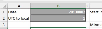

In cell B1, select the desired date.
The entered date.

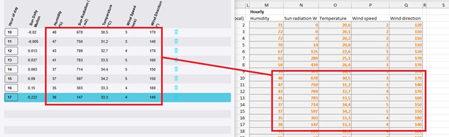

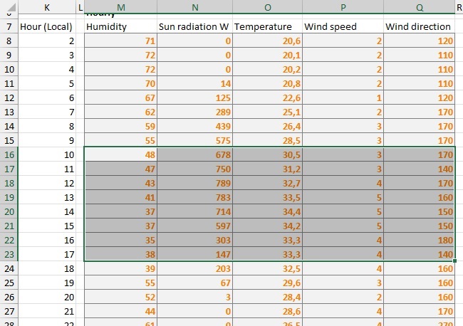

Columns M through Q now show the appropriate values which can be entered into the Heat Overlay's configuration wizard. For each hour-of-the-day as listed in the configuration wizard, the appropriate hour-of-the-day can be found in column K.
The weather data for specific hours of the selected day.
For example, the row of values where column K has the hour "12" listed, should be entered in the Heat Overlay's configuration wizard for the hour-of-day 12.
The weather data for hour 12 of the specified date, local time.

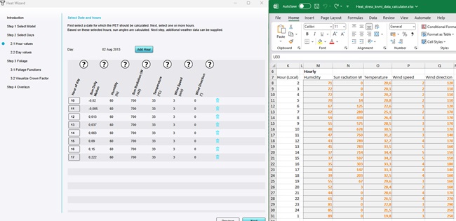

In the Tygron Client, reopen the Heat Overlay's configuration wizard and continue to the step for date and time selection.
Ensure the appropriate date for the Project is set.
Continue to the step for hour values.
The wizard and the calculator side-by-side.

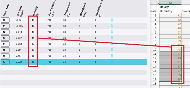

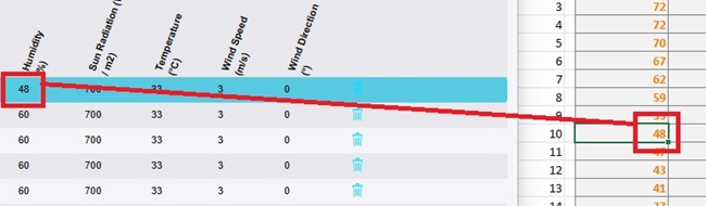

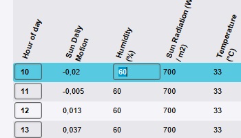

Starting with "Humidity", double-click on the first value listed.
Double-click to edit.
Enter the value listed for that (local) hour in the calculator tool. Then press enter.
The value changed.
Repeat this for all humidity values for the applicable (local) hours.
All values for humidity changed.
Repeat this for the other hourly weather values as well.
All values changed.
In the configuration wizard, continue to the next step for the daily values.

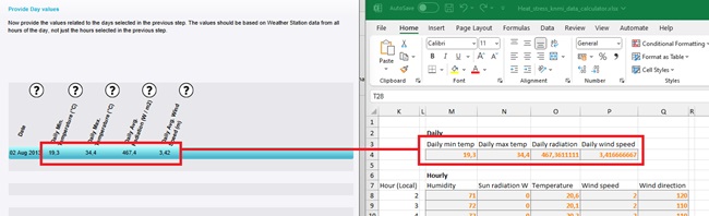

The daily values are calculated in row 4, in columns M through P. Enter the values listed there in the configuration wizard as well.
Set the daily values.

The results are now different, most likely more nuanced, and more accurate for the indicated day and location.
New results for heat stress.
Final assignments
  1. Find a location which is in shade only part of the day. Use the measurement tool to see the values of shade over the day and compare it to the values of heat over the day.
  2. For the Heat Overlay, activate the "Show Difference" option. Repeat this for the child Overlays. Next, add trees to the Project area as an Action or a Measure.
    • Investigate the Heat Overlay, with emphasis on the difference view of the Overlay. Do you see the spatial effects of the taken Action?
    • Investigate the Shade result, with emphasis on the difference view of the Overlay. Do you see a (partial) correlation between the changes in shading and heat?
    • Investigate the wind speed result, with emphasis on the difference view of the Overlay. Do you see a (partial) correlation between the changes in wind speed and heat?
