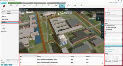

Open the Indicators option in the Header. Now we go add, remove and edit a default indicator. When you select the Indicators option you will get an overview of all indicators that are present in the project in the left panel. When you hover over the Indicators option a menu opens up with some default indicators.
You can pick one of these indicators and as soon as you picked one you will see the indicator is added to the top bar in the Viewer interface. Pick another indicator and add this to the project but this time you use the dropdown menu in the left bottom of the left panel and select an indicator followed by selecting Add. Again the Indicator is added to the top bar and to the list of indicators in the left panel. Repeat this with two more indicators, for example also add the building indicator if you didn’t do that already.
Now select an indicator in the left panel and select remove in the left bottom corner. The indicator can now be removed from the entire project. To edit the indicator you can select one in the left panel so the options for this specific indicator will be displayed in the right panel. In this example, we use the building indicator. In the right panel, you can edit the name and the image and give a description of what this indicator calculates. In the middle panel, the target for this indicator can be set. In this case the target is divided in types of buildings. Per building type, a target can be set. Based on the type of building you either fill out the number of houses or the amount of floor space. How this is divided can be checked on this Tygron Support wiki page Housing (Indicator).
Select some building types and enter some targets in the middle panel. Next, select the indicator in the Viewer interface by clicking on the indicator in the top bar. A new panel opens up and here you see the target you have set and the description you could enter in the right panel.
