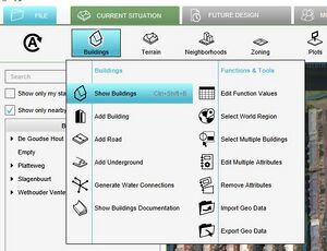

Drow-down menu of Buildings in the Tygron Platform, shown when hovering over the Building's button in the ribbon bar

Hover over Buildings in the ribbon bar and select the Show Buildings option in the drop-down menu. An overview panel opens on the left side of the editor interface. Here you can see the buildings that are present in your project, grouped by their Functions category.
