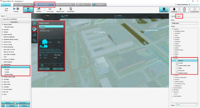

Create actions in the Action Menu. Go to the FUTURE DESIGN tab and select the Actions option. In the left panel all Action Menus from the entire project are displayed. If you prefer, you can check the Show Only For My Stakeholder checkbox to make the overview in the left panel more clear. Select one of the Action Menus which correspond with one of the action menus you see in the Viewer interface. Open the Action Menu in the action menu panel on the left side of the viewer interface and notice the same options are available in the left panel and in the Action Menu itself.
Overview of the actions in the Tygron Platform.
In the right panel you switch to the Actions tab and notice the checkboxes of the same actions are checked here. That’s how you can add new actions to existing action menus. Just check one or more checkboxes of one or more functions and notice they are immediately added to the action list on the left panel and in the Action Menu in the viewer interface. Just simply uncheck the checkbox on the right panel to remove an action from the Action Menu. To create a new Action Menu you can select Add in the left bottom corner of the left panel and a new menu will appear in the Action Menu list in the left panel.
In the right panel, in the general tab you can enter a name for the Action Menu and select a suitable image. Than switch to the Actions tab in the right panel and start adding functions from the functions list. Please take some time to go trough the list and explore what kind of functions are available in the Tygron Platform. After you have edited your Action Menu you can test the action in your project. Open the Action Menu and perform the action by making a selection in the 3D Visualization. You can choose a kind of drawing tool, for example a line when you draw a road or a block when you build a flat. Create a selection and notice some parts are green and some are red. The red parts can not be build on. In the legend you see an explanation why you cannot build on that spot. You don’t have to clear the red parts of your selection, when you choose Build only the green parts will be filled with your new construction.
Notice you have started a Test Run because you are testing the project and you are editing on top of the baseline project by performing new planning actions. As a result editing your project is no longer possible as all editor options are greyed out. To continue editing your project stop the Test Run. Keep in mind that when you do, all actions performed will disappear and the project will go back to the baseline project. So this is a completely different option that building new constructions in the baseline project as you do when editing the project in the CURRENT SITUATION tab.
