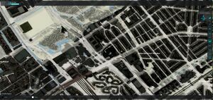

This project showcases a method for calculating the 3-30-300 policy guidelines in the Tygron Platform.
The demo is a working project in which a number of generally available Grid Overlays in the Tygron Platform are combined to perform specific policy-dictated calculations. Following the 3-30-300 guidelines as closely as possible, these methods calculate sight-lines onto trees, foliage coverage, and distance to significant usable green spaces.
3-30-300
3-30-300 is a set of policy guidelines which are intended to provide consistent and testable metric for a green urban environment[1]. These guidelines have been composed externally but can be implemented in Project in the Tygron Platform freely. The name refers to the separate guidelines which are each defined by one of the numbers. The guidelines are always combined for a complete consideration, but the individual rules and their implementations are best described separately.
Although the guidelines are well known, they also leave room to interpretation and thus varying implementations. The implementations demonstrated here strike a balance between leveraging the Tygron Platform's effective means of calculation and the flexibility and verisimilitude of the results. As such, they serve as a powerful springboard for creating ones own accepted means of calculation.

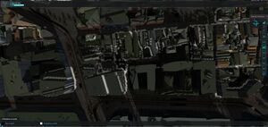

3-30-300 Implementation
Each rule is codified in an Overlay, with a number of sub Overlays. The sub Overlays each form a step in the total calculation, and are in the order that the steps in the calculation are taken. By first inspecting the parent Overlay, the net result can be seen. Then, by inspecting the sub Overlays in order, the calculations can be progressively made clear.
Some calculations are performed separately and are explained separately. This is because the calculations are complex and warrant the ability to understand what is happening separate from the greater calculation, or because the calculations are reused between rules. The results of these separate calculations are separate Overlays, with their own sub Overlays for their own calculations.

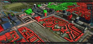

Estimations of walls of residences, and whether they can see a tree or not.
Main article: How to compute residential walls with sight of trees
Rule 3 dictates that, from any residence, at least 3 trees should be visible. Although explicitly counting the amount of trees is currently not possible, it ís possible to draw sight-lines from trees, detect outside walls of residences, and combine the two to find the walls which do or do not have sight on a tree.
The Overlay "Rule-3 (Sight on tree)" demonstrates the results of calculation to test for this rule. The child Overlay is a sub calculation which works towards the final result.
The calculation also relies on 2 maps which are calculated separately.

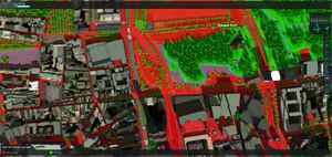

Estimations of public space, and whether there is foliage coverage there.
Main article: How to compute the presence of foliage in public spaces
Rule 30 dictates that 30% of the public space must feature foliage. The Tygron Platform offers some options for estimating the presence of foliage. The definition of public space can be manually defined with a few simple rules.
The Overlay "Rule-30 (Foliage coverage)" demonstrates the results of calculation to test for this rule. The child Overlay is a sub calculation which works towards the final result.
The calculation also relies on a map which is calculated separately.

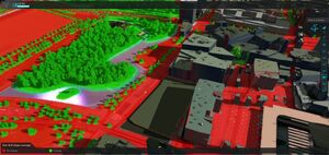

Rule 300 dictates that a residence must be at most 300m away from a publicly accessible and usable green area of at least 1 hectare in size (10.000 m²). This requires calculating in which locations 1 hectare of qualifying green can be found, then computing the routes which allow reaching that green in 300m.
The Overlay "Rule-300 (Green nearby)" demonstrates the results of calculation to test for this rule. The child Overlays are sub calculations which work towards the final result.
  • A map of Residences is created. Note that this can directly leverage the setup from the 3-rule as well.
  • A map of Public space is created. Note that this can directly leverage the setup from the 30-rule as well.
  • An Average Overlay creates a map of VEGETATION_FRACTION.
  • A Combo Overlay filters it, so that any remaining green is in a public space, and thus public green.
  • An Average Overlay checks how much of the area within a 80 meter radius is public green. This provides a fraction of how much of such green is nearby.
    (A circle with 80 meter radius has an area of around 2 hectares total. This means 50% of the circle should be green to reach 1 hectare, allowing for capturing green structures with irregular shapes and extents.)
  • A Combo Overlay calculates from that fraction and the radius of 80 meters the amount of public green nearby, in m².
  • A Combo Overlay checks whether the amount of public green nearby is sufficient to count for this rule. I.e. whether there is more than 10.000 m² (1 hectare). The result is points where there is 1 hectare nearby.
  • An Average Overlay draws the 80 meter radii of those points.
  • A Combo Overlay checks which public green overlaps with the computed radii. This results in a map which highlights all the public green which is part of a large enough green structure.
  • A Travel Distance Overlay, set to a distance of 300m, uses the green structures as destinations. It is set to allow travel routes based on bicycles and pedestrians.
  • A Combo Overlay combines Walls of residences and travel distance, to display which residences are or are not in the specified distance.

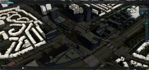

Residence walls
Estimations of the outside walls of buildings with residential units.
Main article: How to make a Grid Overlay of residence walls
Determining the locations of walls requires finding the places where the DSM makes a sudden jump upward. This can be done by spatially smoothing the DSM out.
  • Add a Heightmap Overlay set to DTM.
  • Add a Heightmap Overlay set to DSM.
  • Add an Average Overlay, which slightly averages out the DSM spatially.
  • Add a Combo Overlay which checks that the averaged DSM is greater than the DTM as well as the DSM. This provides a map where places are highlighted where there are changes in height due to Buildings being present, and will specifically find cells just on the "outside" of the wall.
  • Add an Average Overlay which slightly averages the residences, so for any residential Building a few cells around it have a non-zero value as well.
  • Use a Combo Overlay to finds all the cells which are both height differences just outside walls, and just outside residences.

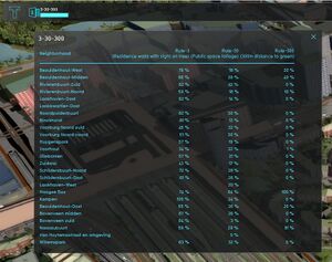

Indicator
Percentages to what degree the policies are met. Note that for rule-3 and rule-300 the goals are 100%, but for rule-30 the goal is actually 30%.
An Indicator can use queries to automatically aggregate values from Overlays and display statistical results. Because all the result Overlays produce either a NO_DATA (ignorable), 0 (does not meet requirements), or 1 (meets requirements), the following query can be permuted in 6 variants (3 overlays and 2 values) to compute a score for each of the 3 rules:
SELECT_LANDSIZE_WHERE_NEIGHBORHOOD_IS_X_AND_GRID_WITH_ATTRIBUTE_IS_[attribute]_AND_MINGRIDVALUE_IS_[value]
The Overlays for rule-3, rule-30, and rule-300 have been given the Attributes OVERLAY_RULE_3, OVERLAY_RULE_30, and OVERLAY_RULE_300 respectively.
The values are 0, or 1, for "all testable locations" and "all good locations" respectively.
Results are aggregated per Neighborhood.
