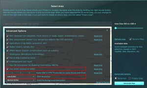

The elevation model is generated when a Project is first created. The advanced options allow you to select the used data sources and resolution for the elevation model.
In the Netherlands, the following data sources are used to construct the elevation model:
Name Resolution Description Source
ESRI DTM 3m by 3m Dataset supplied by Rijkswaterstaat to ESRI, based on AHN2. https://www.arcgis.com/home/item.html?id=58a541efc59545e6b7137f961d7de883
AHN DSM 0.5m by 0.5m, 1m by 1m, or 2.5m by 2.5m, depending on selected options. Raw data from Actueel Hoogte Bestand
AHN DTM 0.5m by 0.5m, 1m by 1m, or 2.5m by 2.5m, depending on selected options. Interpolated (surface level) data based on Actueel Hoogte Bestand
Features Presence of features of the built environment https://www.pdok.nl/introductie/-/article/basisregistratie-grootschalige-topografie-bgt- (BGT) and https://www.kadaster.nl/-/top10nl (Top10NL)
  • By default the AHN3 is used for the DTM and DSM. AHN2, AHN3, or AHN4 can be selected.
  • If AHN4 is used in a location where coverage is incomplete, no fallback data will be available which means data will be missing in that part of the project.
  • By default the BGT is used for the features in the 3D Visualization. If the BGT is deactivated in the advanced options panel, TOP10NL is used.

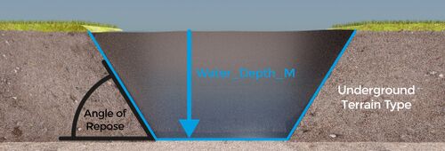

Water bodies, found in terrain surface types, are lowered a few meters relative to the elevation of the surrounding surface. The following parameters are used:
From the DTM a point is selected at the waterbody's edge, or as close as possible. The Angle of repose value of the underground Terrain Type present in that point is determined. A downward slope is created at the determined angle of repose. The downward slope continues until either it meets the slope generated from the other end, or it reaches the determined default water depth relative to the DTM. This means that thin waterways will not be as deep as their default water depth allows them to be, and that large water bodies are likely to have flat water bottoms.
The resulting terrain height changes are made part of the DTM.
The angle of repose and water depth m attributes determine the slope and depth of the waterway. When the waterway is wide enough, the water bottom will be flat.

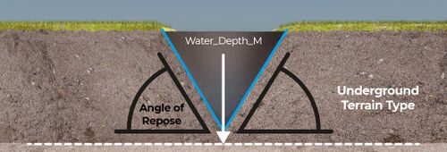

Because of the angle of repose, the slopes of a narrow waterway can end in a point, despite the fact that the waterway is not yet as deep as determined in the water depth m attribute.
