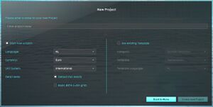

Creating a new Project begins with the configuration of the general information for the new Project. These include the following:
After setting these details, progressing through the New Project Wizard starts a Session for the new Project, in which all additional configuration is effected.

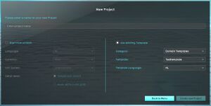

Using a Template
New Project Wizard, to set the new Project's properties.
After setting a name for the Project, rather than create a new Project from scratch, it is possible to base the new Project on an existing Template Project. Any Project which is marked as a Template Project, and which can be accessed in the Editor by a user, can also be used as a Template.
Using a Template Project allows for the selection of a language, but only a language which is also available for the Template Project itself. Other properties, such as the currency, unit system, and Project Type, cannot be changed.
After selecting a Template Project to use, progressing through the New Project Wizard starts a Session of the selected Template Project, and then saves a copy under the provided name for the new Project. The copy is cleared of all geographical data. The running Session is then used to effect additional configurations.

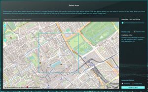

A new Project will require geographical properties to be set, known as the project area. This includes the size of the Project and its geographical location.
The size of the project can be set by using a slider to set the desired size. By default, a Project is square with an equal with and height. However, it is also possible to opt for a rectangular Project, allowing the width and height of the Project to be set independently from one another. However, the ratio between width and height can at most be 1:4. A Project is always cardinally aligned and cannot be rotated.
A location can be selected by moving the viewport with the right mouse button, and placing the center of the extent of the Project with the left mouse button.
It is also possible to drag-and-drop a GeoJSON file onto the map. Based on the polygons in the file, the center and size of the project is recalculated to precisely fit the polygons provided. After doing so, the location and size of the Project can be adjusted further. See How to create an interest area GeoJSON to learn more on how to create such a file.
