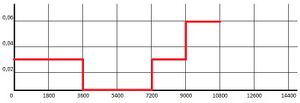

Definition by end
Up until specific times, a certain value is applicable.
Rainfall and evapotranspiration use an interpretation by which the times indicate up to when the value is used.

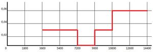

Definition by start
From certain times onward, a certain value is applicable.
The speeds of hydraulic structures use an interpretation by which the times indicate from when onward a value is used.

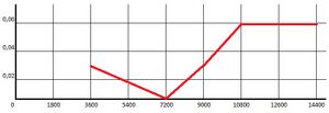

Interpolated
The applicable value is interpolated.
Heights and target water levels of breaches and hydraulic structures use an interpretation by which the used value is interpolated based on the current time in the simulation, the preceding and upcoming defined time in the time sequence, and the associated value.
