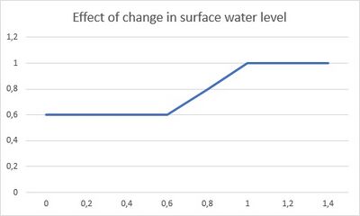

Ground water level managed by water areas
The ground water level can also be managed by water areas, which control the surface water levels. To make sure ground water levels do not rise (too much), surface water levels in the water areas can be lowered automatically with respect to the subsidence. This process is called indexation. The new ground water level can then be estimated based on the indexation on the managed water level of surface water and the calculated subsidence of the previous year. The increment in ground water level is rarely exactly the adjustment of the managed surface water level and is often less, depending on the relative depth of the surface water level. The following formulas have been developed to estimate the increase of the ground water level.
The new relative surface water level depth is calculated as:
Next, based on the old and new depths, the ground water depth change is divided into three sections, each which its own rate of contribution.
Finally, the ground water depth change is calculated and the new ground water depth is obtained:
