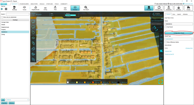

The wizard will be able to guide you through the configuration of the overlay. It will pass through a number of steps in which individual aspects of the subsidence overlay are set up. The wizard can be opened by clicking on the configuration wizard button in the general tab of the subsidence overlay.
