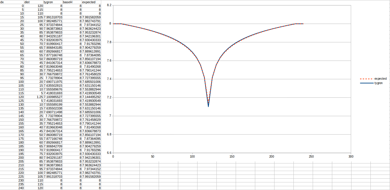

Test results
Important in all these tests is the amount of chosen days it was ran, because the formula says nothing on how long it should take until the stable situation is reached. Secondly, the measurements are done relative to the impenetrable soil, which is situated 10 meters below the surface.

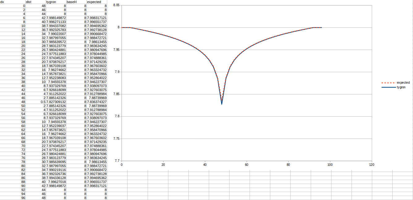

Test case 1
cell size: 5 m;
k: 4.4 m/day;
R: 110;
Q0: 50 m³ /day;
Simulation days n: 64 days;

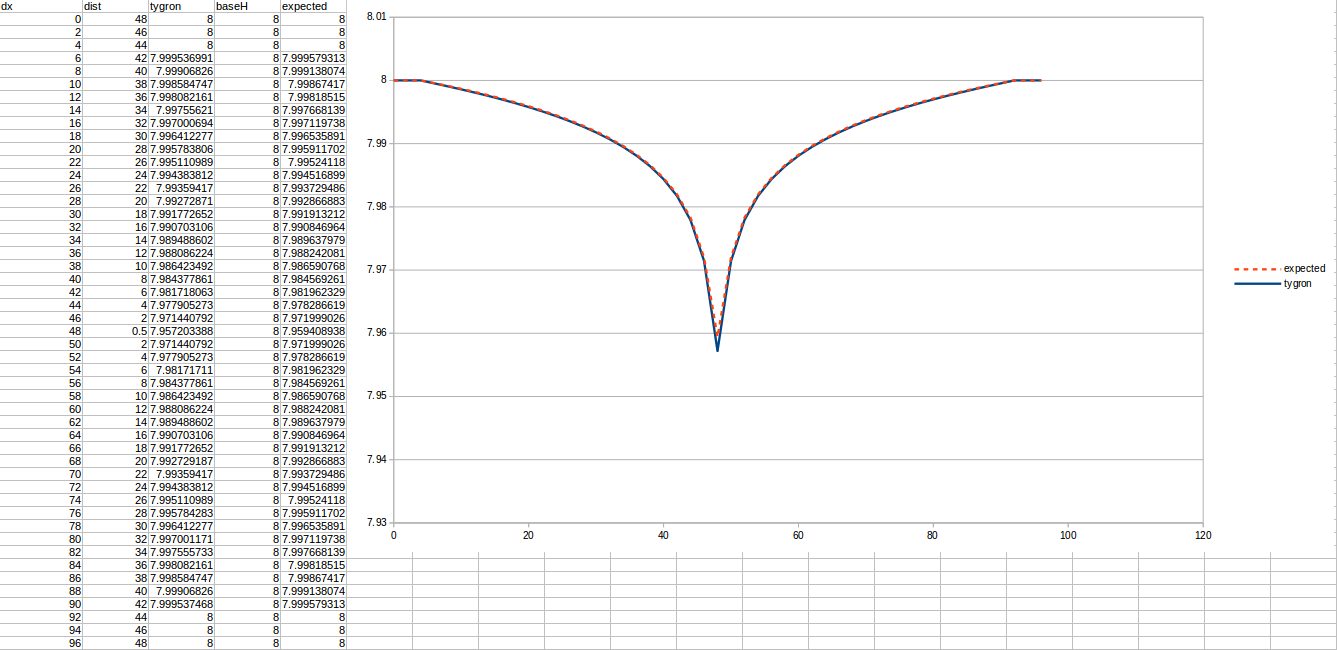

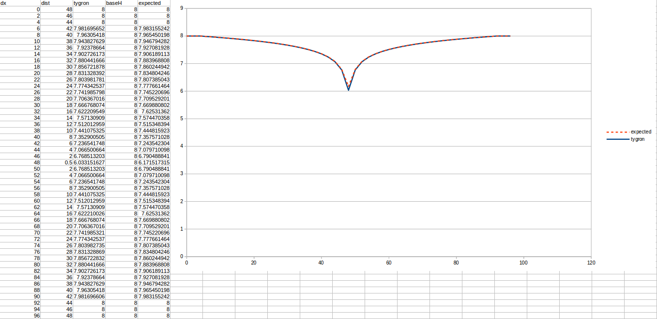

Test case 2
cell size: 5 m;
k: 2.2 m/day;
R: 110;
Q0: 50 m³ /day;
Simulation days n: 128 days;

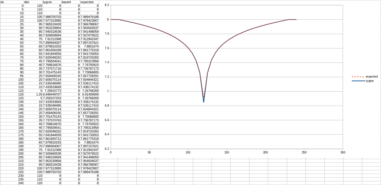

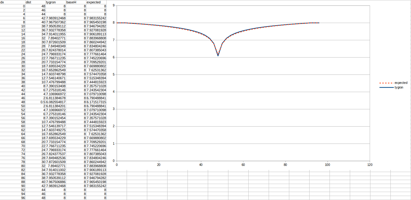

Test case 3
cell size: 5 m;
k: 2.2 m/day;
R: 110;
Q0: 25 m³/day;

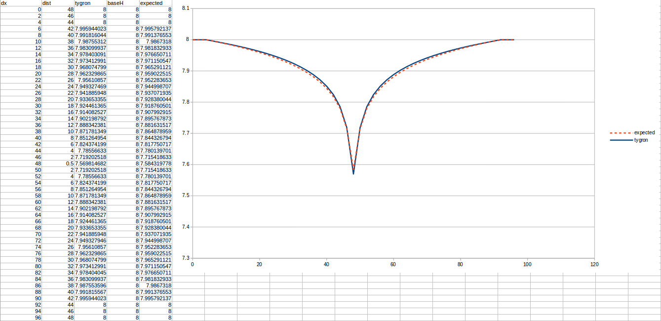

Test case 4
cell size: 5 m;
k: 0.44 m/day;
R: 110;
Q0: 4 m³/day;
Simulation days n: 512 days;

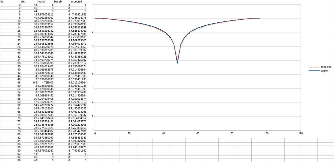

Test case 5
cell size: 5 m;
k: 0.11 m/day;
R: 110;
Q0: 4 m³/day;
Simulation days n: 1256 days;

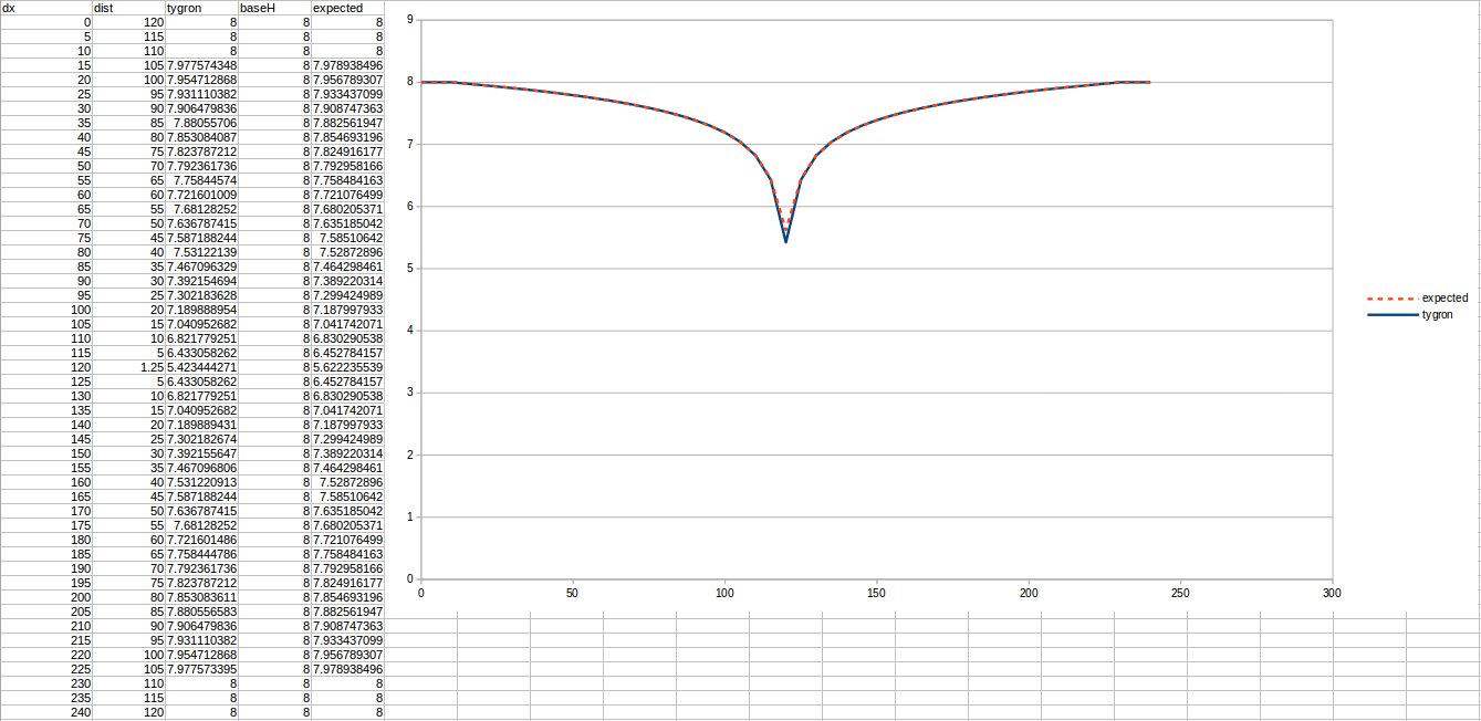

Test case 6
cell size: 5 m;
k: 2.2 m/day;
R: 110;
Q0: 10;

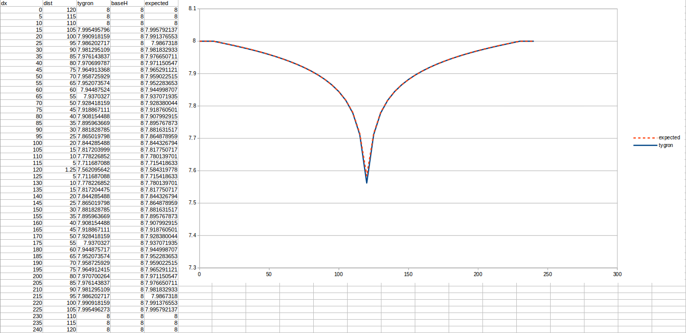

Test case 7
cell size: 2 m;
k: 2_2 m/day;
R: 110;
Q0: 1;

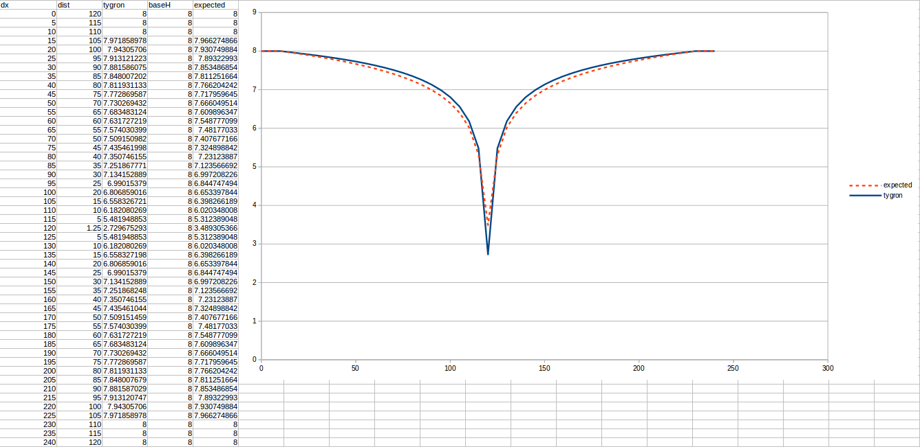

Test case 8
cell size: 2 m;
k: 0.22 m/day;
R: 110;
Q0: 1;
Simulation days n: 256 days;
