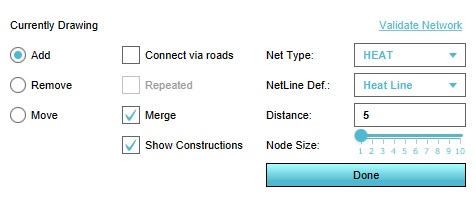

The bottom panel in the editor, when editing the network.

Options
To fine-tune how the editing options work, some configuration settings are available.
Connect via roads
The option for forcing paths over roads.
If checked, the path between the start node and the end node is calculated dynamically to only travel via terrain with the pipes permitted property. In general, this is functionally the same as only using roads. More nodes will be placed where required, connected with net lines. If unchecked, a net line will be created directly connected the indicated nodes. I.e. as the crow flies. (This option is not available while removing.)
Repeated
The option for iterating the removal action along the net line.
If checked, when a net line is removed, if due to that removal net lines are left which are dead ends, those net lines are removed as well until all those dead ends are removed. This means that long stretches comprised of multiple net lines can be removed as though they were a single net line, up to the point where they branch off into other net lines. If unchecked, only the specific net line clicked will be removed. (This option is only available while removing.)
Merge
The option for merging the ends of net line end points.
If checked, when you place a node very close to another node in the 3D Visualization of the same network, the existing node will be used in place of the otherwise newly placed node. This means that when you're drawing a line and the endpoint of the net line is drawn very close to an existing node, the line you're drawing will "snap" onto the existing node. If unchecked, a new node will always be created, no matter how close to an existing node the new node is placed. (This option is not available while removing.)
Show Constructions
The option for hiding and showing constructions while editing.
If checked, this constructions will remain visible while drawing. If unchecked, constructions will be hidden so you can place nodes more easily.
Net Type
The option for which network type to edit.
This is the network currently being edited. Only the network being edited is visible in the 3D Visualization. You can only select networks for which net line definitions exist.
Net Function
The option for what kind of net lines to draw.
This is the net function being placed while drawing new net lines.
Merge Distance
The option for merging distance.
This is the distance for merging nodes. If the endpoint of a net line is placed within this distance from an existing net node, the existing net node is used.
Node Size
The net node visualization size setting.
This is the size used to visualize net nodes while drawing net lines. This is only for clarity while editing, and when editing concludes the net nodes revert o their normal size.
