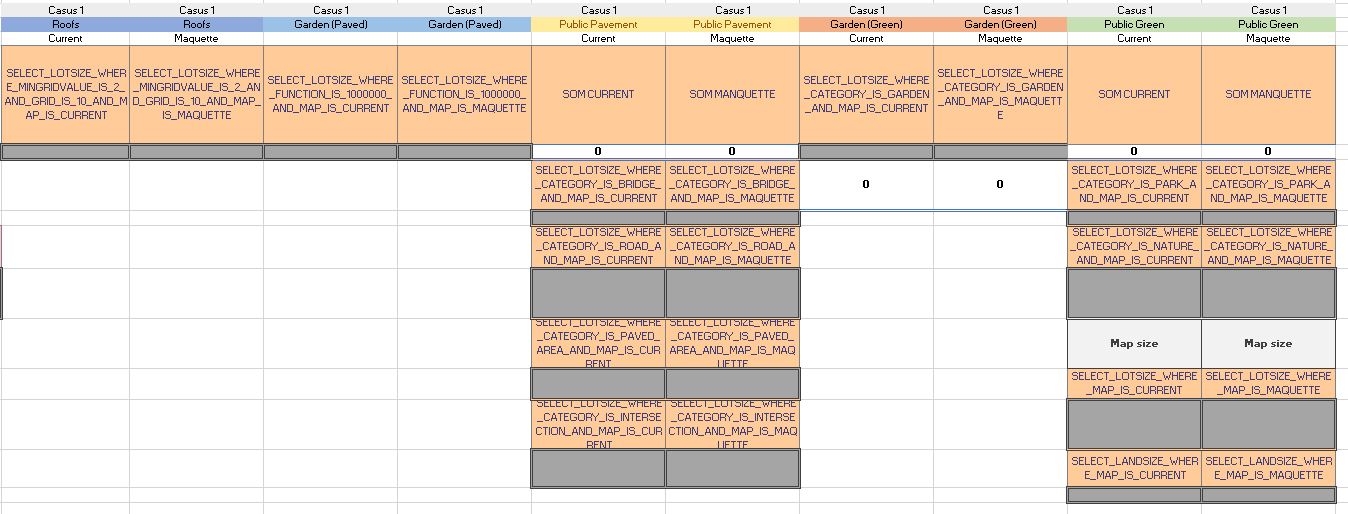

Queries
The final step of realizing the indicator was defining the queries. An import tool with helping to shape indicators is the query tool. This tool can also directly shows the calculated outcomes of the query. The queries used in the Green Garden indicator are summed up below an explanation of their creation.
Roofs
The first step in shaping the indicator was setting up the query for the roofs. To obtain this information from the platform, the query selects all the Buildings in the project with at least one floor (hence:FLOOR_HEIGHT_M) and a minimum floor height of 2m. This floor height was obtained from the model, by making an Average Overlay based on the FLOOR_HEIGHT_M attribute. This is also a useful tool to visualize the area that will be selected.
Garden (paved)
The paved garden parameter is based on a new Function made for this use case. Gardens in the Tygron Platform are by default green gardens, so this query obtains the area value of all the gardens. For paved gardens, a new garden type was created by duplicating a Function and editing the function values, .
Public Pavement
The third parameter is public pavement, this includes all the public hard surfaces, like sidewalks and roads. The query, therefore, is a SUM statement in Excel with all the public hard surfaces used in the project of Leusderkwartier. These parameters included values of bridge, road, paved area and intersections.
Garden (green)
As explained above, green gardens are currently the default type of garden in the Tygron Platform. This query, therefore, obtains the lotsize of all the gardens in the model. Subsequently, the area value of the paved garden is substracted of this total.
Public Green
The last category is public green, this category is also a sum function. This parameter sums the surfaces of the categories parks and nature and also add the area of terrain that has no function, this is often grassland. By subtracting the total area with the total built environment, the difference will show the undeveloped land.
The Queries used in the Green Garden meter.

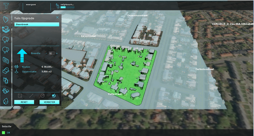

The visible output of the indicator uses a HTML table to show the output. The values in the output are percentages, these percentages are obtained by dividing each value with the total area of the project. In the project Measures were created. During a session, for example transforming a paved garden into a green garden could be done. Because the indicator both calculates the current and future design, the difference between those two parameters shows possible progress and what consequences of a certain measure can be.
Implementing the Indicator
The last step was using the step in a scenario session, therefor I needed as previously said adjust the standard garden of the platform, to make a distinction between paved and green gardens. The function values of the paved garden are now similar to those of an urban square. In the scenario created for the Amersfoort Green Garden Use Case, it was possible for inhabitants and the municipality to upgrade their paved gardens to green garden.
