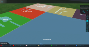

- Zoom out a bit with the mouse scroll wheel button and notice that the project exists of different sections.
- Click on the Neighborhoods Overlay to see the different sections (neighborhoods). The names of the neighborhoods correspond with the parameters in the Water Connection Generator

Step 2. Click on the Neighborhoods overlay in the Overlay bar and notice the different neighborhoods
