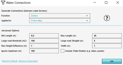

The Water Connection Generator panel

Select the function and the location of the to be generated connections
There are a few basic options which form the foundation of using the Water Connection Generator. These options are displayed at the top of the Water Connection Generator's window.

Advanced Options
The advanced options
There are a variety of advanced options available which allow fine-tuning the exact circumstances under which buildings are or aren't generated. The provided defaults are meant to allow using the Water Connection Generator and getting reasonable result with minimal effort, but by further refining the generator's configuration its possible to improve the results for a given location and use-case.

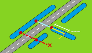

Large road straight
In this schematic image, the large road straight setting is set on 30m. Only one water connection is generated, since there is one waterway that is perpendicular to another waterway.
The large road straight parameter is used to measure if waterways are perpendicular to each other. It is measured by extending the placed water connection by x meters and if it is still in a waterway or body, then it is perpendicular and accepted. For parallel waterways, this check will not create a water connection when the defined x is sufficiently large.

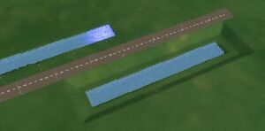

  • Two waterways with a levee inbetween. A stricter max height difference can prevent the creation of an unrealistic water connection.

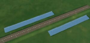

  • Two waterways, of which one is situated 5 meters lower than the other, where there typically would be no water connection.
The maximum height difference in meters that is allowed for the water connection te be generated. The height difference is measured on the surface where the water connection would be. This parameter can therefore be used to detect levees on the surface and prevent water connections through them. Additionally, this same parameter can be used to prevent connections being created for water ways that have very different water levels.
