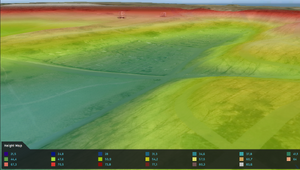

Height map
The height map is the visualization of the DTM in the 3D Visualization.
