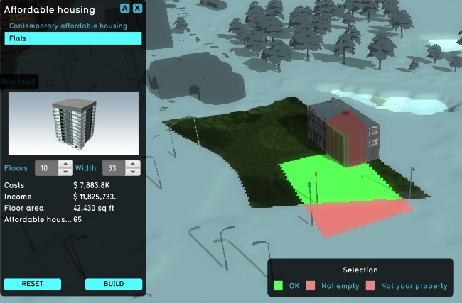

While editing or running a Planning Session for a project, it may be necessary to make a selection in the 3D Visualization. In many cases, there are parts of the project area that are not valid for selection. For example, when making a selection for placing a building, the building may not be placed in a location where a building already exists. Similarly, when making a selection to remove a part of a specific building, any part of the selection that does not actually select the building will be invalid.
When a selection is made, it may be composed of both valid and invalid parts. If the action, for which the selection is made, is performed, only the valid parts of the selection will be used to perform the action. Invalid parts of your selection are ignored. When the selection has other effects while selecting, such as the calculation of a price for the action to take, the invalid parts of your selection are ignored as well.
Validity colors
A selection which is partially valid and invalid. Only the empty (transparent) parts are valid for selection, the rest of the area is greyish-blue. The green area is selected and valid. The red area is selected and invalid. Note that the bottom of the water is greyish-blue, meaning a selection on the water would be invalid.

This is what the project looks like normally. This means this part of the 3D Visualization would be valid for selection.
Greyish-blue
This is a part of the project that is not valid for selection. This can be for a number of reasons. When creating a building, it could be that a building already exists in that location. When removing parts of a building, the selection is only valid when the building is selected.
Green
This part of the project area has been selected, and is also a valid selection. When taking the action for which this selection is made, this part of the 3D Visualization will be affected.
Red
This part of the project area has been selected, but is not a valid selection. When taking the action for which this selection is made, this part of the 3D Visualization will remain unaffected. Other effects of the selection, such as the calculation of a price for the action, are unaffected by invalid parts of the selection. That is to say the price of a building will not increase when an invalid selection is added to the current selection.
