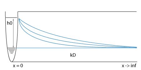

In this benchmark, the ground water table is initially the same as the water level in the waterway. Then, the level in the waterway suddenly rises with h0 meters. This causes water to infiltrate into the ground, slowly raising the ground water table as well.
Situation of the waterway level change benchmark for groundwater

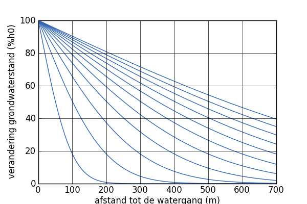

De grafiek laat de relatieve verandering zien van de grondwaterstand na 1, 4, 9, 16, 25, 36, 49, 64, 81, 100 en 121 dagen, berekend met bovenstaande formule.

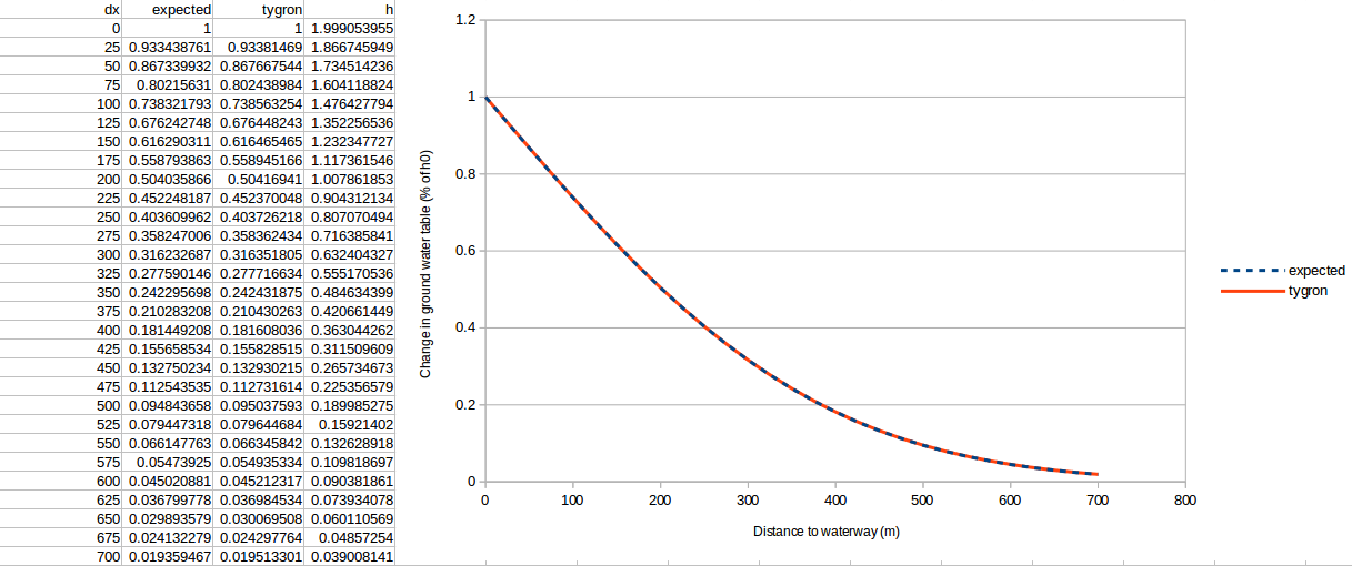

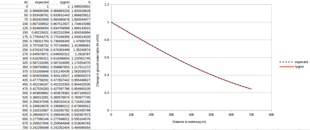

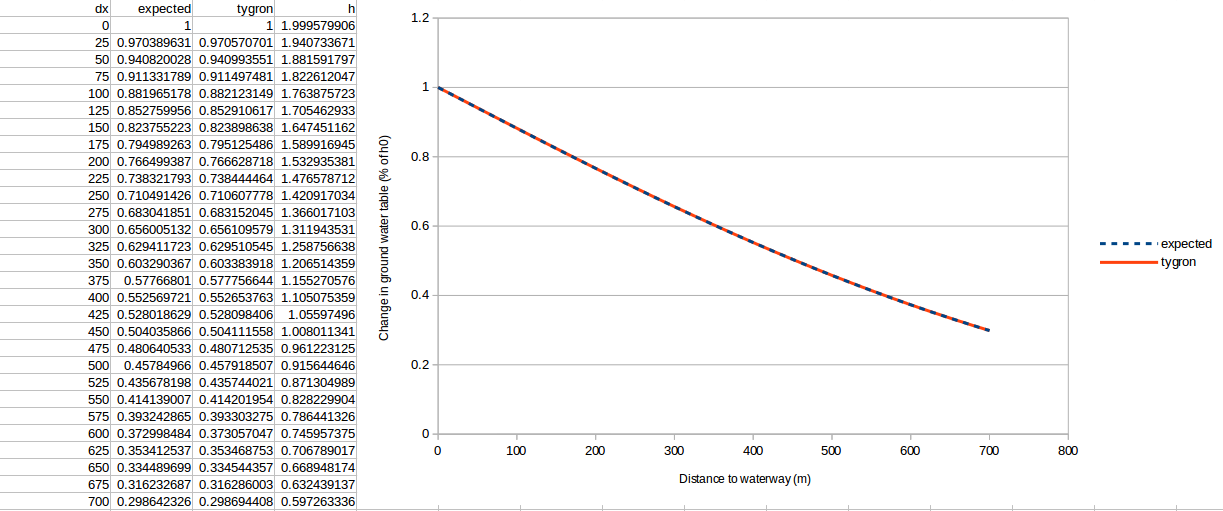

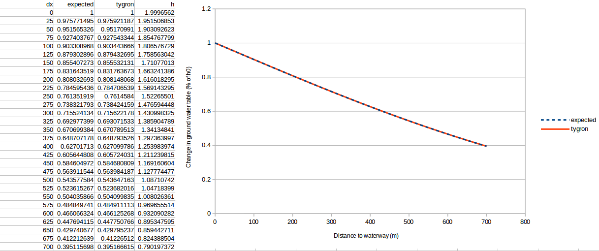

The results are generated for four simulation periods: 16 days, 64 days, 81 days and 121 days. The noted h is the increase of ground water level in meters, which went from 2 to 4 meters in the waterway. The dx is the distance in meters to the waterway. As you will be able to inspect below, the lines align very well.
16 Days
64 Days
81 Days
121 Days
