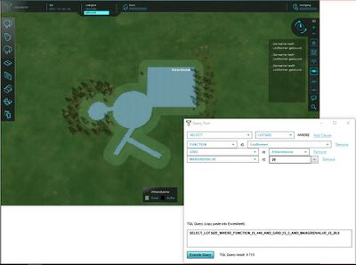

Testing the setup
A result of a test run with a distance overlay and a query for deciduous trees with 20 meters.
In order to test the setup in a dynamic case, we optionally have to do one or more things. We can add the deciduous trees function to the Actions of our Stakeholder. Furthermore, we can add open water to the actions or our stakeholder as well. With these two actions added to our stakeholder, we can start a test run and plan both deciduous trees and open water. By keeping the Query tool opened, we can, at any time, execute the query and calculate the current amount of square meters of deciduous trees within 20 meters of water! Optionally, you can construct an indicator that calculates this query instead, and visualize this number for users during a Single or Multi-user session.

Testing the setup
With the added Bus stop function to the Actions of our Stakeholder we can start a test run and start building our Bus stops in the project area. By keeping the Query tool opened, we can, at any time, execute the query and calculate the current number of houses located within 200 meters of two bus stops.The following values will be used for the TQL query: MAXGRIDVALUE: 200 and GRIDVALUE: 2.
