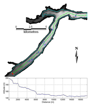

  • Figure (a): DEM used, with cross-section along the center line, and location of the output points. The red line indicates the location of the boundary condition and the blue polygon is the modeled area.

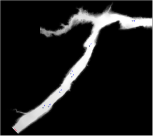

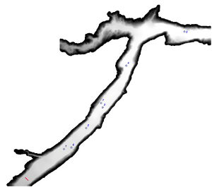

The provided ascii height file named Test5DEM.asc is first processed in order to limit the domain according to the provided area shape. Also the no-value heights were converted to 400, which is about the maximum height value seen in the original Test5DEM.asc-file. See the following images:
  • Original Test5DEM.asc
  • Adjusted Test5DEM.asc

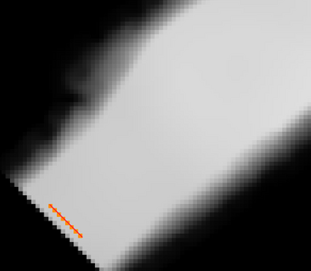

Next, the inlets we placed on the line with coordinates:
x y
232595 830480
232785 830290
Combined with the used grid size of 25 m, this resulted in the usage of 8 individual, single celled inlets. For the location, see the following image.
Inlet positions and the red line indicating the benchmark input.
The inlets were configured as followed:

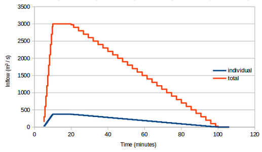

  • Inlet Q (m):
The total inflow was given by the graph in the introduction. We use 8 individual inlets, so therefore the individual amount is 8 times smaller than the total amount. See the image below:
Inlet influx graph used by the Tygron Platform
