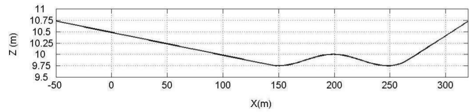

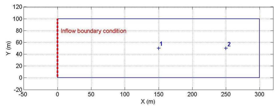

This test consists of a sloping topography with two depressions separated by an obstruction as illustrated in Figure (a & b). The dimensions of the domain are 300m longitudinally (X) x 100m transversally (Y). A varying inflow discharge, see Figure (c), is applied as an upstream boundary condition at the left-hand end, causing a flood wave to travel down the 1:200 slope. While the total inflow volume is just sufficient to fill the left-hand side depression at x=150m, some of this volume is expected to overtop the obstruction because of momentum conservation and settle in the depression on the right-hand side at x=250m. The model is run until time T=900s (15 mins) to allow the water to settle.
Below is a plan and profile of the DEM used in Test 3. The area modeled is a perfect rectangle extending from X=0 to X=300m and from Y=0 to Y=100m as represented.
Fig. a: Top down situation.
Fig. b: Side view situation.

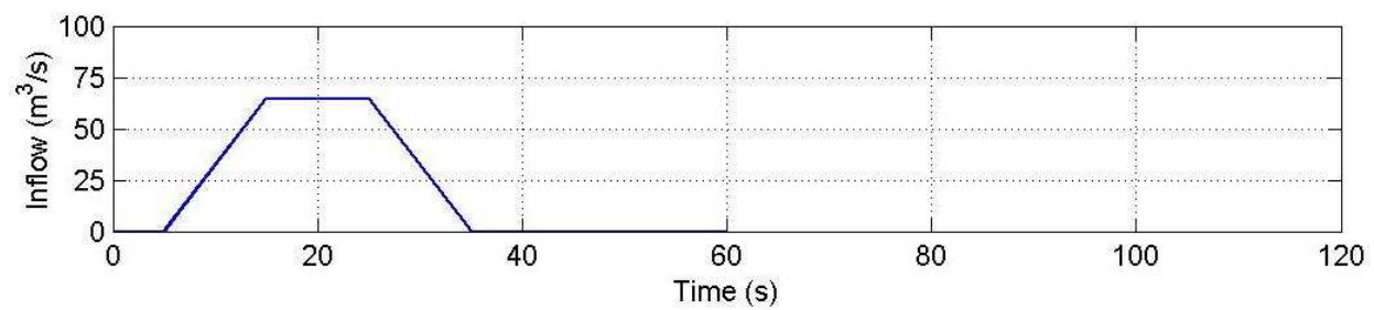

Fig. c: Inflow hydrograph used as upstream boundary condition.

  • Inflow boundary condition along the dashed red line in Figure (a). Table provided as part of dataset.
  • All other boundaries are closed.

  • Inlet Q (m):
Inlet influx graph used by the Tygron Platform

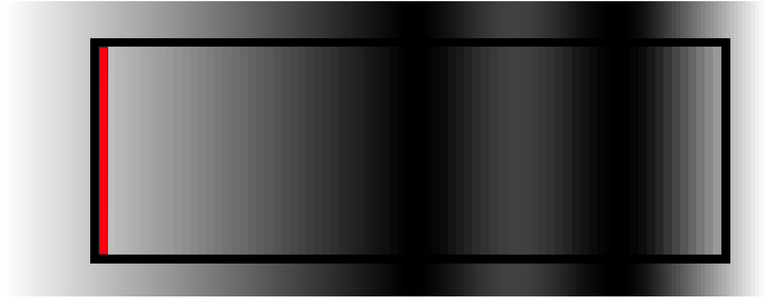

  • Inlet locations:
Inlet positions and the black rectangle indicating the border cells. The heightmap outside the border rectangle is not inside the project area.

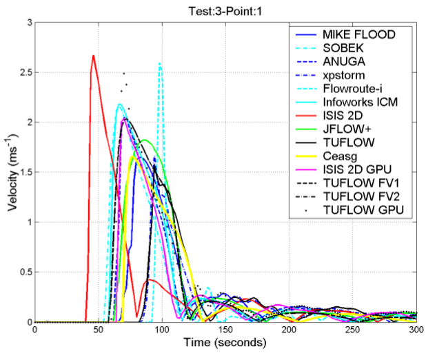

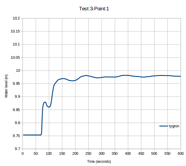

Measured point graphs are displayed below:

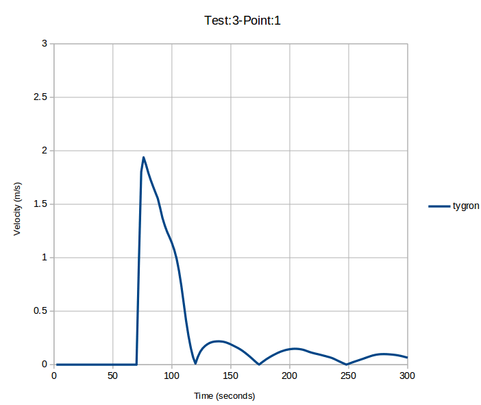

  • Velocities at p1 generated by the Tygron Platform on the left and generated by others on the right.

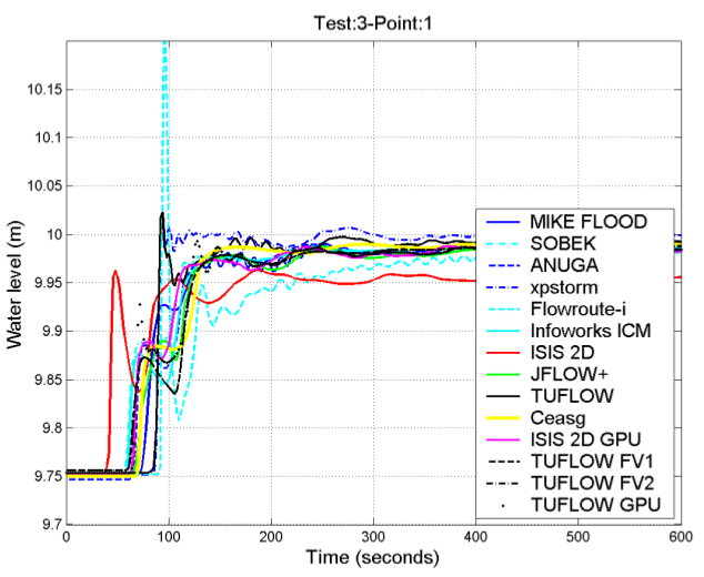

  • Water levels for p1 generated by the Tygron Platform on the left and generated by others on the right.

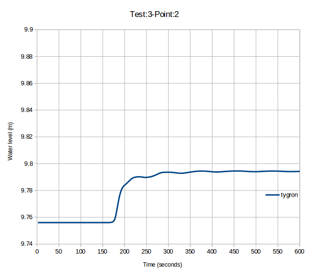

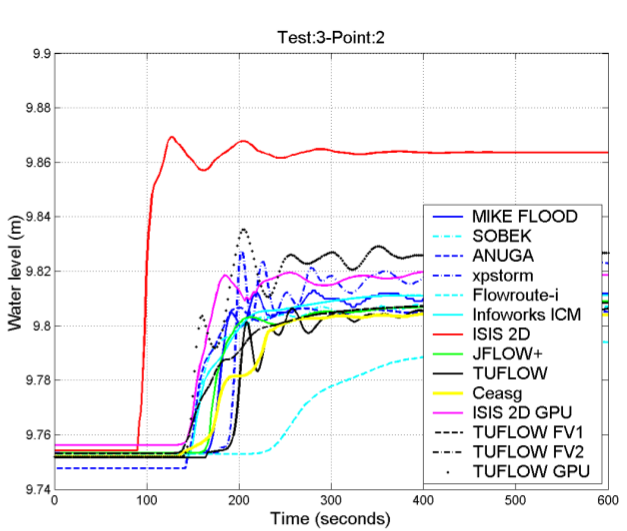

  • Water levels for p2 generated by the Tygron Platform on the left and generated by others on the right.
