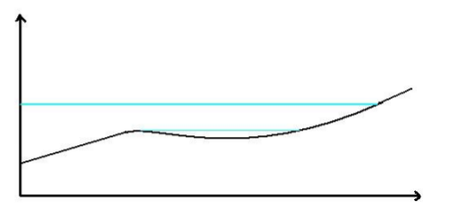

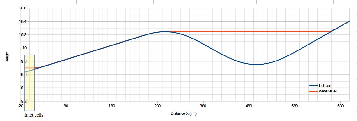

Fig. a: Sloping topography with depression

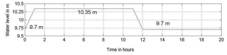

This test consists of a sloping topography with a depression as illustrated in Figure (a). The modeled domain is a perfect 700m x 100m rectangle. A varying water level, see Figure (b), is applied as a boundary condition along the entire length of the left-hand side of the rectangle, causing the water to rise to level 10.35m. This elevation is maintained for long enough for the water to fill the depression and become horizontal over the entire domain. It is then lowered back to its initial state, causing the water level in the pond to become horizontal at the same elevation as the sill, 10.25m.

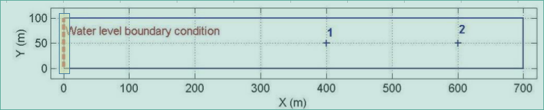

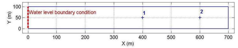

Fig. b: Top down situation
Fig. c: Water level rise at the left boundary

  • Varying water level along the dashed red line in Figure (a). Table provided as part of dataset.
  • All other boundaries are closed.

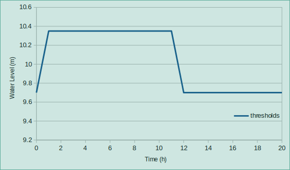

The threshold array was set using a .csv-file that approximated there water level over time. It is approximated since our water levels remain the same for a given period of time (no linear interpolation between time key - values). However, this setup proved accurate enough. The inletthresholds.csv-file can be found in the zip-file below.

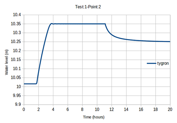

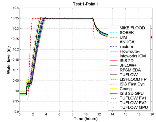

Measured point graphs are displayed below:

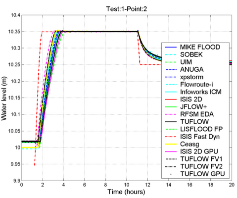

  • Graph of point 1 generated by the Tygron Platform on the left and generated by others on the right.
