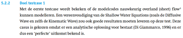

This test case will validate whether a shallow water calculation tool can calculate sheet flow accurately. An analytic solution of this case is provided by (Di Giammarco, 1996).
The reference grid resolution is 20 by 20 meters. The Manning roughness is 0.015. The surface is expected to be impenetrable, meaning that there is no rain water infiltrating into the underground. Water that reaches the lowest border of this test case is expected to flow out of the system.

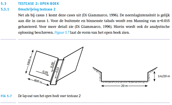

Test case 2 adds the following aspects with respect to test case 1:
  • Flow coming from two directions that meet in the middle
  • Deeper surface water flow
An analytic solution is available for this case. However, it is more complicated that test case 1. The influence of model boundaries should be less in this test case compared to test case 1.

The lay-out of the terrain has a slanted V-shape. In the middle is a ditch, which is horizontal in the x-direction but slanted downwards in the y-direction with a value of 0.02. The terrain around the ditch is slanted downwards in the x-direction with a value of 0.05. Furthermore, the ditch is +-0.05m deep at the top. In the y-direction is remains horizontal. For the exact measurements see figure 5.9 above. A graphical impression of the height map in this testcase is given below. Again first the original height map and next the height map adjusted for ensuring a constant slope per grid cell x- and y-direction.

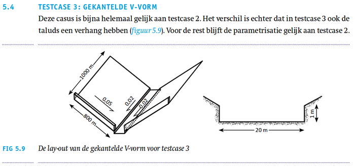

This test case adds a slope in the y-direction as well. Due to this extra slope, the flow directions will not be perpendicular anymore to the sides of the grid cells. Instead, the flow direction will vary per grid cell and this is what this test case will validate.
Fig 5.9 Layout of testcase 3 with a sloped ditch and sloped terrain in both directions
Purpose of testcase 3
Setup
The lay-out of the terrain has a slanted V-shape. In the middle is a ditch, which is horizontal in the x-direction but slanted downwards in the y-direction. The terrain around the ditch is slanted downwards in the x-direction with a value of 0.05. In the y-direction is is slanted similar to the ditch, with a value of 0.02. For the exact measurements see figure 5.9 above. A graphical impression of the height map in this testcase is given below. Again first the original height map and next the height map adjusted for ensuring a constant slope per grid cell x- and y-direction.

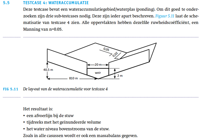

This testcase contains a ponding problem. This testcase is subdivided into 3 sub-testcases in order to investigate several aspects of this ponder problem. Each is described below. See image 5.11 for the layout of the problem. Each of the surfaces in this test case have a Manning roughness value of 0.05. A weir is situated at the bottom of the sloped terrain, causing the creation of a pond during the simulation.

Setup
For each test case the base setup is the same. A graphical impression of the height map in this testcase is given below. Again first the original height map and next the height map adjusted for ensuring a constant slope per grid cell x- and y-direction.

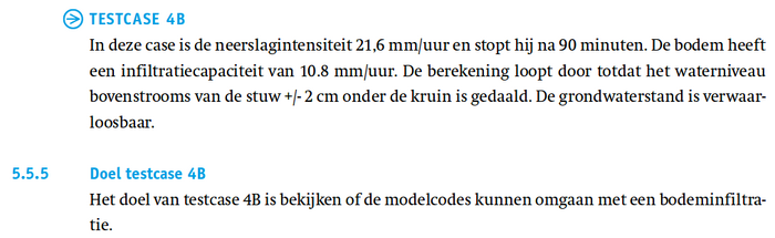

In this testcase the amount of rainfall is 21.6 mm per hour and lasts for 90 minutes. The underground has an infiltration capacity of 10.8 mm per hour. The simulation runs until the water level has lowered to about +/- 2cm below the crest of the weir. The effects of the groundwater table can be ignored.

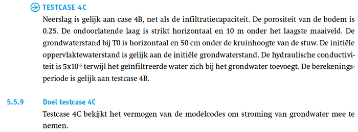

In this testcase, the amount of rainfall and the infiltration capacity are equal to testcase 4B. The porosity of the soil is now set to 0.25. The impenetrable layer is strictly horizontal and 10 meters below the lowest surface height. The groundwatertable at t=0 is horizontal, 50 cm below the height of the weir. The initial surface water level is equal to the initial groundwatertable. The hydraulic condictivity is 5x10-5 for water infiltration from the surface to the underground. The simulation time is equal to testcase 4B.
