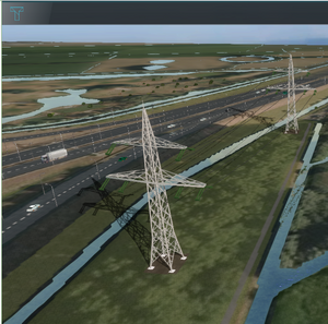

Example of Tranmission Towers and powerlines
This Attribute can be added to a Transmission Tower Building to connect its powerlines to a subsequent Transmission Tower. The value of the attribute represents the ID of the subsequent Transmission Tower. When this attribute is added, the Transmission Tower will be oriented (rotated) to the tower it is connected to.
Building attributes in the right panel showing the POWER_LINE_BUILDING_ID
  • It is only possible to connect to one other tower.
  • When importing or drawing new Transmission Towers, make sure that each new Transmission Tower is a separate Building. This to prevent an incorrect representation of the connected Transmission towers.
