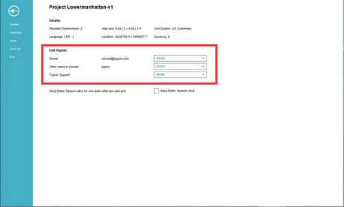

How to share the template with other users in the domain:
  1. Load in the Editor the template project to be shared with the domain
  2. Select "File" when in main view
  3. Select "Permissions"
  4. Change the entry for "Other users in domain" to "Read"
  5. Save project
