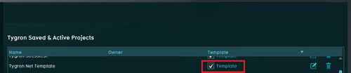

Setting the Project as a Template
How to flag the Project to be usable as a template:
  1. Log in to the main menu (make sure you have domain-admin rights)
  2. Go to Options and select Projects
  3. Click on the check box named "Template" to mark the project as a template
Setting a project as a template can only be done by users with Domain Administrator rights. When a project has been turned into a template project, the read and write permissions will change. This is to ensure that nobody accidentally edits the project template. The permissions will be set to either none or read, so the project cannot be edited anymore. By default only the creator can read the template and the template is not shared with other users within your domain. Please refer to the next paragraph on how to make templates available for a domain.
