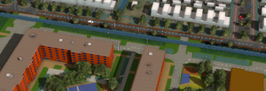

Original Measure of City Plan with bridge connections situated under water and on sloped terrain.
