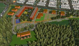

In this demo project an architectural plan [1] is imported to a location in the Netherlands by means of an DXF file. This file is made in AutoCAD, slightly adjusted for demo purposes and exported to DXF.

- The Test Run will start and the new plan will appear. Notice that the plan is visualized as one big building. We will fix this in the next section. For now you have created a new measure which was imported from a DXF file.

- Activate the Measure as before. Notice that the plan is imported correctly now. If you want to compare you can always activate the Example Measure to check for any errors.
