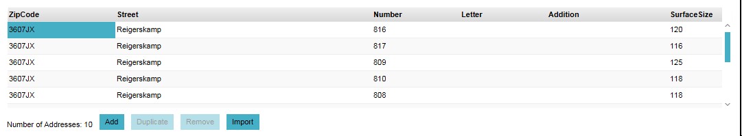

With a building selected on the left panel, it is possible to edit its address on the bottom panel. In case a (newly added) building lacks an address, it is possible to select 'import'. The address will then be assigned automatically to the selected building, if available. In case a building is in such a planning state that no address is already known, it is also possible to enter a desired address in the name field of the building. By selecting the 'Add' button on the bottom panel, the address-as-name will be added to the building as address property. It is also possible to duplicate or remove addresses from this list.
Bottom panel with address properties of selected building
