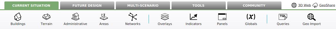

When a project is created in the Tygron Platform, Buildings are automatically added by Geo Plugins to initialize the current situation of your project. Buildings can also be added and removed to the current situation of your project by using the editor. To add or remove buildings to an existing project, start an editing session of your project and once loaded, select current situation in the ribbon bar and click on the Buildings button:

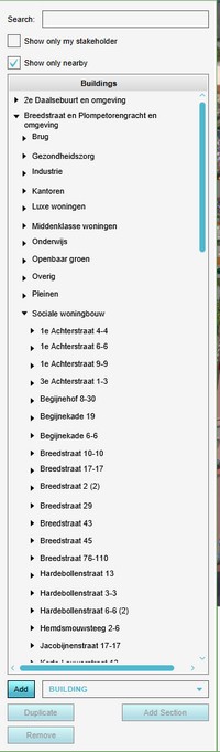

- By selecting a type followed by the Add button on the bottom of list of buildings, a new building item appears on the list. The list is alphabetical per building type. The new building is not yet present in the project area, since it has not been placed. For details on adding / changing a selection from a building: see below.
How to add buildings:
- Select Current Situation
- Select Buildings on the ribbon bar
- Select the desired building type from the drop down list
- Select 'Add' from the bottom of the list
- Notice a new building has been added to the building list
