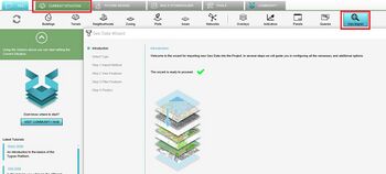

Each of these wizards contain comparable steps which are described below. The wizard can be found by following these steps:
