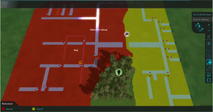

- Take a look at the Watershed Overlay. This overlay shows the calculated watershed areas. For example: rainfall water that falls on the terrain in the red watershed area, flows to the water terrains in the red watershed area. Notice that the colors of the watershed areas are the same as their corresponding discharge areas. (see Pumping stations Overlay) Notice that the forest area is not part of a watershed area, since the forest retains the water. Also check out the Surface Average Direction result result type for this forest area.

- Click again on the Watershed Overlay and notice that the road area depicted with the question mark icon is also not part of a watershed area. Since there are no culverts that connect the water terrains parallel with the road with the other water terrains, the water terrains next to the road are not included in the watershed calculations.

Step 1. See the calculated watershed areas by clicking on the Watershed overlay.
