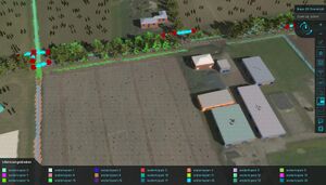

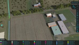

Input Discharge areas versus result type
Presented here are in the left image the Area overlay showing the initial Discharge Areas (green and orange) and in the right image the Discharge Areas result overlay showing the propagated discharge areas (green, orange and blue).
