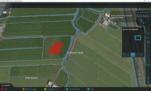

  1. Click anywhere in the 3D Visualization, and use the arrow keys on your keyboard to move around in the world. You can also drag the camera around by right-clicking (and holding the right mouse button down) in the 3D Visualization and dragging the world around. Use the scroll wheel to zoom in- and out.
  2. Step 2: Groundwater Spatial Overlay
    On the right-hand side of the viewer interface you can see the navigation panel with overlay icons. Hover over the various icons to see a tooltip with their name. Find the overlay named "Groundwater (spatial)", and click on it. This will show the overlay in the 3D Visualization. This overlay shows the groundwater level in the underground.
  3. Step 3: Activate Play
    At the bottom of the interface a legend will now appear, with on the left-hand side of the legend a few buttons to "play" the overlay. Click on the "play" button, and you will see how the state of the groundwater level changes over time.
  4. Hover over the icon for the overlay again, and notice that more options appear for overlays related to groundwater. These are the child overlays, which can display more types of results from the groundwater simulation.
  5. Notice multiple Overlays exist, each showing a specific result or type of data related to seepage:
    1. The "Groundwater (Spatial)" Overlay calculates and shows the result for the seepage calculation, with a static amount of pressure and resistance affecting the groundwater levels, without any configured fluctuation.
    2. The "Groundwater (Fluctiation)" Overlay calculates and shows the results for a seepage calculation, in which natural pressure and resistance are configured to limit base seepage, so that the effect of seepage fluctuation is more visibly demonstrated.
    3. A GeoTIFF Overlay showing spatial seepage pressures. It has two child Overlays demonstrating the configuration for resistance values of 10 days, and the resistance values of 500 days.
  6. Finally, notice a number of icons floating in the world. The orange icons are of particular note; these denote points-of-interest which you can take a closer look at. You can click on any to open a panel with more information.
Points of interest
Below some additional information on elements in the Seepage Project which can be interesting to explore.
The project offers a number of points of interest to inspect in greater detail. A number of these points have been emphasized with popups.
Seepage under land
At the location of this popup, underground pressure will cause seepage to occur, slowly increasing the groundwater level.
Select the "Groundwater (Spatial)" Overlay, and play the overlay. As time progresses, the patch of land where seepage occurs will experience a rising groundwater level, until the pressure of the seepage even causes the water to seep onto the surface.
Place a point measurement on the wet patch, and select the "Groundwater (Fluctuation)" Overlay. Play the Overlay. You will see the measurement shows a varying rate at which seepage occurs, dictated by the seepage fluctuation which varies over time. Especially notable is that the groundwater level increase at the start of the simulation (when the fluctuation parameter is negative) is clearly less than at the end of the simulation (when the fluctuation parameter is 0).
Seepage under waterway
At the location of this popup, underground pressure will cause seepage to occur under the waterway.
Place a line measurement along the waterway where seepage occurs, and select the "Surface last value (Spatial)" Overlay. Add as a base Overlay the "Surface elevation (Spatial)" Overlay, and select the "sum" mode. Play the overlay. You will see the initial state of the waterway is a dry waterbed. However, as time and seepage progresses, eventually water will seep up from the underground into the waterway.
Using the same measurement, select the "Groundwater (Fluctuation)" Overlay. Disable the "sum" mode. (You do not need to change the base overlay, as both Overlays share the same elevation model.) Play the overlay. You will see the groundwater level rises at a varying rate, dictated by the seepage fluctuation which varies over time. Especially notable is that the groundwater level increase at the start of the simulation (when the fluctuation parameter is negative) is clearly less than at the end of the simulation (when the fluctuation parameter is 0).
