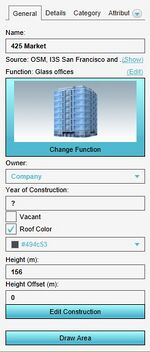

5 To inspect one of the buildings in the model, click on the Current situation tab on the Buildings button and select the building that is referred to with the arrow icon.
6 On the right panel, the attributes such as the name of the building and its function are displayed. Notice that this building has the function office, which is known from the OSM dataset.

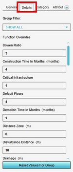

7 Select the Details tab and scroll through the different attributes and values. These attributes are called function values. Notice that some attributes have values and some attributes have a value of 0. These values are used in calculation models of Grid Overlays.
