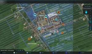

  5. Finally, notice a number of icons floating in the 3D Visualization. The orange icons are of particular note; these denote points-of-interest which you can take a closer look at. You can click on any to open a panel with more information.
Points of interest
The project offers a number of points of interest to inspect in greater detail. A number of these points have been emphasized with orange popups with various icons.

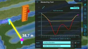

More in-depth analysis of water in the project can be achieved using the Measuring tool. Go to the X popup in the project, and place a point measurement anywhere to see a graph of the waterlevels in that location during the simulation.
You can also place a line measurement, perpendicular across one or multiple canals. You can get a cross-section of the waterlevels relative to datum by doing the following:
  • Select the rainfall overlay
  • Place a line measurement
  • In the "Base" Overlay dropdown, select the "Surface Elevation".
  • Check the "Sum" option, to add the values of the two layers together
  • Select the "Fit to graph" mode to use the full extent of the measuring window.
The result is a cross-section of the water and the terrain height.

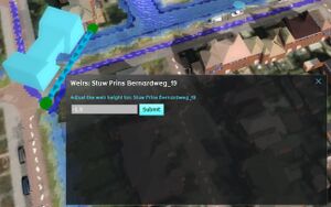

The automatically generated control panels for weirs allow you to change their configuration and see the results.
Switch to the "Future design" tab. Select any of the blue weir icons in the 3D Visualization to open a panel which allows you to control them. Specifically, the height of the weir can be changed. Change the weir height to 1 meter lower (e.g., change 3.2 into 2.2, or -1.6 into -2.6), and select "Submit".
After making the change, the rainfall overlay will be recalculated, and the new results will indicate how water would act with the weir set to its new height. To compare the original results and the new results, select the rainfall overlay, and activate its "difference" mode by selecting "Show difference". The overlay will now show where the resulting amounts of water have changed due to your action.

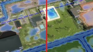

Placing a water storing park instead of natural grassland helps alleviate the water issues. Left: before placing the park. Right: after placing the park.
Switch to the "Future design" tab, and then in the Viewer interface the Action Menu will appear. Open the menu with "Water Storage" options, and select the "City park with water storage" action. Now draw a selection in the city, in locations which experience excessive water retention. When you have made the selection, select "Confirm". This will add a new park with water storage facilities to that location in the 3D Visualization.
