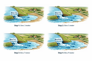

Setting the breach width for each iteration step
With iterative calculation, you essentially split your simulation into a number of steps. In our example, the breach should grow after each step. To model this, we first need to identify where the breach width is defined.
A breach is modeled as an Area in the Tygron Platform. This area has an attribute called BREACH_WIDTH. The value of this attribute needs to be updated after each iteration step. This can be done using an Excel panel. In the demo, this panel is called Update Attribute Breach Width (Before): Breach.
When you download this panel via the Debug Excel sheet, you can see how this is implemented. In the Excel file, cell B5 contains the formula: 3 + B3 * 2. This formula states that the breach starts with a width of 3 meters and grows by 2 meters with each iteration step. As mentioned, this is not a realistic formula, but it demonstrates the mechanism. You can replace it with your own formula if needed.
To do this, it is important to understand that the value in cell B3 is retrieved using a Query. This query provides the value used in the calculation. In this case, the SELECT_ITERATION query retrieves the current iteration step. The formula in B5 multiplies this value by two and adds 3 meters. The resulting value is then written to the BREACH_WIDTH attribute. This happens because the cell has the name UPDATE_AREA_BREACH_WIDTH_WHERE_AREA_IS_ID, which is a TQL query that updates the Attribute. In the next iteration step, the updated BREACH_WIDTH is used.
